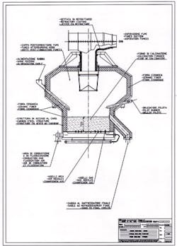

For high-volume production (between 7 and 12 mt/hr of sand), the Hot Rec system consists of a furnace with a base plate made of heat-resistant metal super-alloy and air-gas fluidization nozzles.  A low thermal capacity isolating coating maintains the external carbon steel walls at a temperature below 60°C.
Eco Rec System
Above the furnace there is a hood, whose size is suitable for maintaining the gas for at least 4 seconds and allows the end of combustion.
Combustion is guaranteed by a pilot burner consisting of a flame indicator, which is always on for safety reasons. The gas system is equipped with all the devices required to guarantee safety.

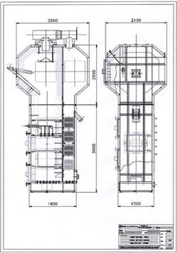

For medium-volume production (between 2 and 7 mt/hr of sand), the Eco Rec system consists of a furnace with a base plate made of heat-resistant metal super-alloy and air-gas fluidization nozzles, similar to the furnace previously described.  A heat exchanger is installed on the hot fume piping at the furnace outlet, and pre-heats the combustion air to 250°C, in counter-flow mode. The final cooler is made of steel and based on the same principle of the fluidization bed, with the addition of the tube bundle.
For low-volume production (between 1 and 2 mt/hr of sand), the Compact Rec system consists of a furnace with a base plate is made of heat-resistant metal super-alloy and air-gas fluidization nozzles.  The sand does not move through the system according to gravity, but according to the concept of communicating vessels applied to the fluid bed: the sand inlet in the furnace has the same height as the cooled sand outlet. The system has a U-shape, in which the inlet column is used for regeneration, whereas the outlet column is used for cooling. Before entering the upper part of the regeneration side, the sand is heated at calcination temperature and then it descends toward the cooling section.
