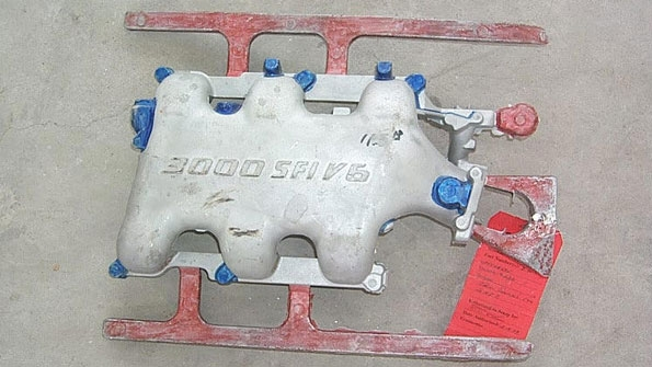

Once the coating procedure for a casting is determined it must be recorded for future reference One method is to mark a sample casting with paint Here unpainted areas have a standard coating the blue areas are trimmed and coated with graphite coating and red painted runners and risers are coated with isolative coating

Isolated heavy sections in the die will require “trimming”.  The next step is to remove or thin the coating in the areas that require rapid solidification.  This can be done with a brass scraper, steel wool, or a wire brush mounted in a die grinder.  After trimming, the exposed steel should be sprayed with HALLCoat986 to prevent aluminum from welding to the steel die.  Now, the die should be reheated to pouring temperature approximately 800o F.
Once the coating procedure for a particular casting is finalized the method must be recorded for future reference.  One method is to mark a sample casting with paint.  In the attached photo, the unpainted areas have a standard coating, the blue painted areas are trimmed and coated with HALLCoat986 graphite coating, and the red painted runners and risers are coated with HALLCoat600 isolative coating.
