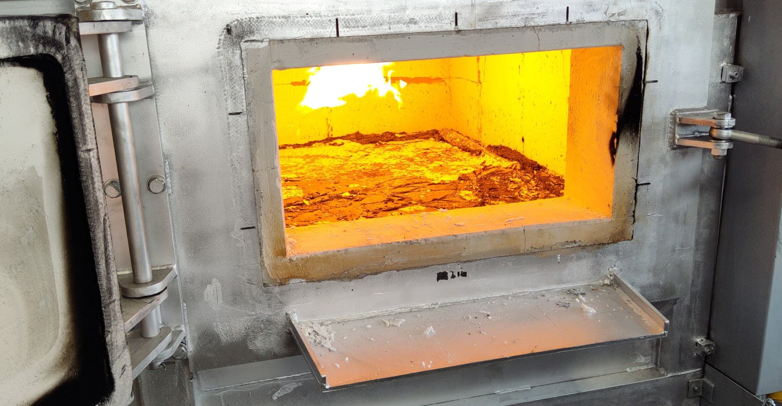

Controlling oxygen concentration is critical for melt quality. Complete isolation of the chamber prevents exhaust gas infiltration, and a specialized dam at the inflow effectively blocks aluminum dross migration from the melting chamber, preserving melt cleanliness without requiring special treatment. In practice, even after six months of continuous operation without cleaning, the oxide film on the molten metal surface remained manageable at just 3- to 5-mm thick – and the adhered dross was soft enough to allow easy removal from the furnace walls.
