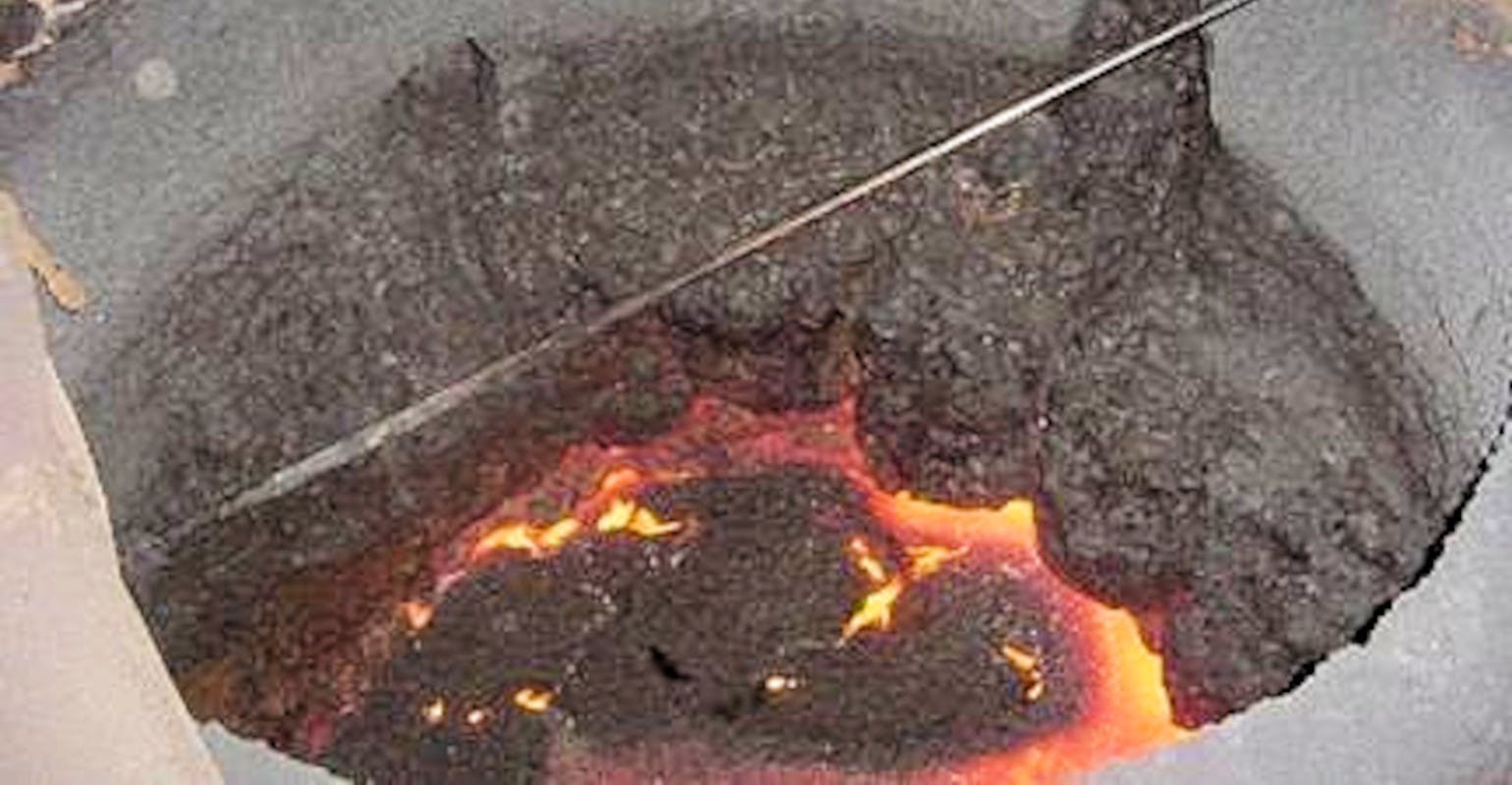

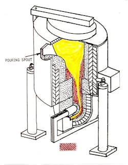

Slag build-up usually manifests as a deposition of low melting oxides, silicates, and sulfides on the side walls of the furnace refractory that reduces furnace capacity. But more important, build-up in the critical inductor loop in channel furnaces can be very harmful. It is critical that this loop of molten metal be continuously maintained. If this loop is allowed to freeze, extreme care is necessary in remelting because the loop may rupture and disrupt the circuit. The relatively narrow melting loops or channels must be kept as clean as possible.
An example of slag build-up on upper case sidewalls, and in the inductor loop and throat areas is shown in Figure 1.
Slag build-up is an on-going process, and a classic nucleation- and crystalline-growth phenomena. Shortly after the initial liquid slag phases start to precipitate as a thin solid film or substrate on any furnace refractory surface, subsequent build-up can proceed more easily and rapidly. This liquid glass or slag phase nucleates easily and grows on the just deposited build-up because the surface of the initial build-up is crystallographically similar to the emulsified slag phases attempting to precipitate out of solution.

The following example illustrates how Redux EF40 flux additions can improve melting efficiency and provide significant downstream melting cost reductions. Foundry “X” was experiencing extensive slag build-up on the upper sidewalls of two 65-ton vertical channel holders. Each channel furnace upper case was lined with a silica refractory while the inductor was lined with a dry-vibratable, alumina-magnesite refractory.
The condition of the channel furnace uppercase after 11 months of operation is shown in Figure 2a. After 11 months of operation from a newly relined furnace, slag build-up reduced the working furnace capacity to less than 35 tons. Build-up was so severe that adhering slag was over 15 inches thick and extremely tenacious in clinging to the furnace walls. The slag build-up was nearly impossible to remove during routine weekend maintenance. The build-up was also responsible for clogging the inductor loop and reducing the working diameter from 12 inches to barely three inches (see Figure 2b.) At this point, the furnaces were typically relined.
Foundry X started to add 0.05% Redux EF40 briquettes to every five-ton cupola transfer ladle and massive quantities of slag were removed daily. During two weeks of continual Redux EF40 additions, starting with one pound per ton, slag and build-up was “systematically peeled from the side walls and an estimated 30 tote bins of slag build-up was removed. This restored the full useful volume to the furnaces.
After three weeks of adding Redux to each transfer ladle, the full working volume of the furnaces was restored. One month after the furnaces were treated with Redux, each furnace was taken off-line for their yearly relines and carefully examined. Foundry X found that there was no sign of refractory erosion. Now, both furnaces last 24 months. Foundry X estimates an annual savings of $250,000 in relining expenses for each furnace. A side benefit has been improved inductor electrical readings that have improved melting efficiency.
