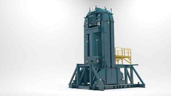

The Avure Quintus hot isostatic press HIP being installed at Alcoa Howmet in Whitehall MI will treat investment cast and additive manufactured parts to improve material and structural qualities It will have a 16m 525ft diameter work zone and operating pressure of 2000 bar

The new hot-isostatic press Alcoa is installing at its investment casting foundry in Whitehall, MI, was initially described as a system to improve aerospace components and structures produced by casting as well as additive manufacturing.
