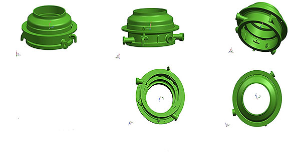

Specifically, the challenges are to reduce the manufacturing cost of investment castings by 25%, with a target cost of $5,800; reduce the manufacturing cycle time to 12 weeks; achieve a typical annual value of 125 units; and improve tolerance controls so as to permit reduction of material and maintain minimum wall thickness.
Challenge participants are required to submit a detailed process proposal and data that demonstrates the viability of the process to produce the described part, stating the conformance to the dimensional and metallurgical requirements.
