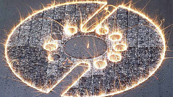

EOS, a developer of direct metal laser sintering technologies for additive manufacturing (DMLS), is collaborating with Plasmo Industrietechnik to develop an online monitoring system for that process. The two companies entered into a cooperative effort at the end of 2013, but the announcement was made earlier this month.  Their “Melt Pool Monitoring” package is seen as a way to enhance quality assurance for additive manufacturing processes in industrial-scale operations.

DMLS is a process that converts a CAD design of a part into .stl file format. This information is read as “layers” by a 3D printer, which deposits metal powders and fuses each success layer to the previous one using a fiber-optic laser, depositing layer after layer of the fused metal to recreate the design in three dimensions.
