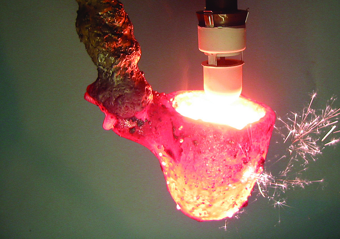

Sintercast sampling cup

SinterCast is a Swedish developer and licenser of compacted graphite iron production technology. The SinterCast technology is the world’s most widely used production and process control system for CGI -- a specialty grade of cast iron that has greater tensile strength, stiffness, and fatigue strength than gray iron or aluminum. It is increasingly popular with diesel and gas engine manufacturers seeking to reduce weight, noise, and emissions for their designs.

The customized sampling cup is a critical part of the SinterCast process, and thus cup deliveries are an indicator of SinterCast CGI production. Through three quarters of 2017 activity, SinterCast sampling cup shipments increased 15% from Q1 to Q2, and 23% from Q2 to Q3, which the company reads as customers rebuilding inventories, thus reinforcing a positive forecast for the fourth quarter.
