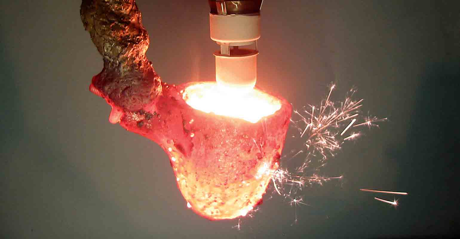

Sintercast sampling cup

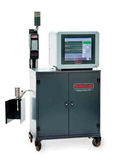

The SinterCast Mini-System 3000 is a mobile process-control unit with a process computer, measurement electronics, and an operator display screen, used in lab settings and in melt shops to manage the SinterCast CGI process-control technology. It can be fitted with a wire-feeder system, as necessary, to adjust melt chemistry manually, as indicated by the control system.
