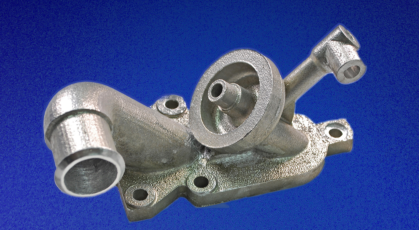

QUESTEK INNOVATIONS LLC has developed a new aluminum alloy for additive manufacturing, capable of high-strength performance at elevated temperatures (200-300°C) in the as-built condition. According to the developer, it is believed to be the first powdered aluminum material to meet those requirements without the need for subsequent heat treatment.
QuesTek is a specialist in Integrated Computational Materials Engineering (ICME) technologies that uses a proprietary methodology to design and apply a family of commercially-available Ferrium® steels being used in demanding aerospace, space, and other applications. The new aluminum alloy will be the subject of coordinated R&D with the German Aerospace Center (DLR.)
DLR will print demonstration components of their design for aeronautics and space applications, and prepare a performance brief for European aerospace manufacturers.
Reportedly, the new alloy will make it possible to print lighter-weight precision components not currently possible with traditional manufacturing methods, such as heat exchangers or other components requiring internal cooling channels or other features that cannot be achieved by machining.
Because of the high-temperature strength of printed components using the new alloy, it also will be possible to reduce weight in parts that currently must be formed in titanium alloys.
