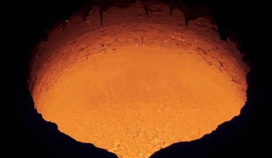

Figure 1 is a typical example of what frequently happens when poor quality, dirty, sand-encrusted charge materials are used.
This type of build-up was typically observed at International Foundry A is shown in Figure 2.
Foundry A is a large, gray iron producer of automotive castings. Some of the items produced are differential housings and three-cylinder engine blocks. Melting is accomplished in a seven-metric ton coreless induction furnace.
Foundry “A”’s 7 metric ton charge consists of 56% steel, 10% pig iron, and 34% foundry returns. The coreless induction furnace is lined with a silica refractory. Tapping temperature from the furnace is 2,789oF (1,532oF.) Slag build-up has been a recurring problem for Foundry A.
The build-up caused increased melting costs from the additional electrical requirements, reduced furnace capacity, loss of melting production, and damage to refractory walls from chipping and descaling. To eliminate these issues, Foundry A tested a relatively new, non-fluoride flux, Redux EF40L.
For the initial trials of Redux EF40L, 0.05% Redux EF40L (7.7 lbs. or 3.5 kgs ) was added to the furnace in two increments. Half of the Redux flux addition was added once the initial 50% of the charge was melted, and the remaining Redux was added in the next back charge.
After just one Redux addition, a significant amount of slag adhering to the furnace refractory was removed simply by skimming it from the surface. After two more treatments, all remaining adhering slag was removed and the furnace walls were clean, as shown in Figure 3. The overall positive impact of the three Redux EF40L flux treatments appeared to remove all slag build-up and return the furnace capacity to 100%.
