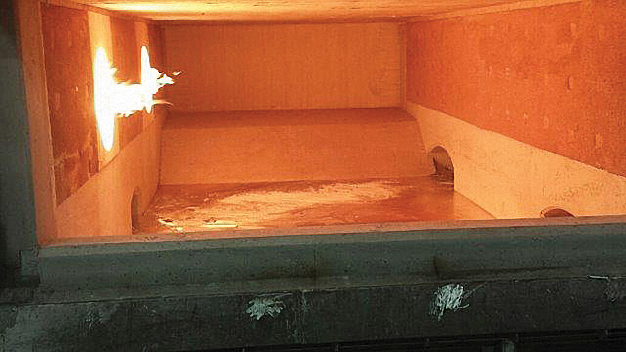

If you have radiant burners in the roof or electric elements in the roof of a holder, or even a high-headroom, side-fired melter, molten metal management is critical to operation and efficiency. For example, if you draw your melters down 6 to 8 in. before refilling them, then chances are they are not at the specified set point temperature anymore. They have to work much harder to get the heat to the aluminum. This same thing applies to radiant roof holders. If you draw them down 5-6” before refilling them chances are they will start to lose temperature.
The greater the temperature difference between the heat source and the media (aluminum) when there is a slight oxide film, the faster will be the transfer of BTUs into that load, to the fourth power. Also, keeping the heat source and the media closer to each other enhances transfer efficiency. Limiting the draw-down to a couple of inches makes furnaces run more efficiently and guarantees better temperature control. The best practice is, whatever comes out of a furnace in 15-20 minutes is replaced with more metal, to fill it up again.
This is especially true with crucible furnaces. Although it may have less of an effect on efficiencies, it will definitely shorten the bowl life. Crucible furnaces have very hot surfaces as heat rises up against the steel plate on top; when 5-6 in. of metal is drawn from the bowl it is replaced with air, which is an insulator. So, heat builds up at the top and there is no place to transfer it. Now, a temperature gradient will build from the middle of the bowl to the top and crack the top of the bowl. Simply charging this crucible furnace evenly, so that the melt never falls lower than a couple of inches, may increase bowl life substantially!
