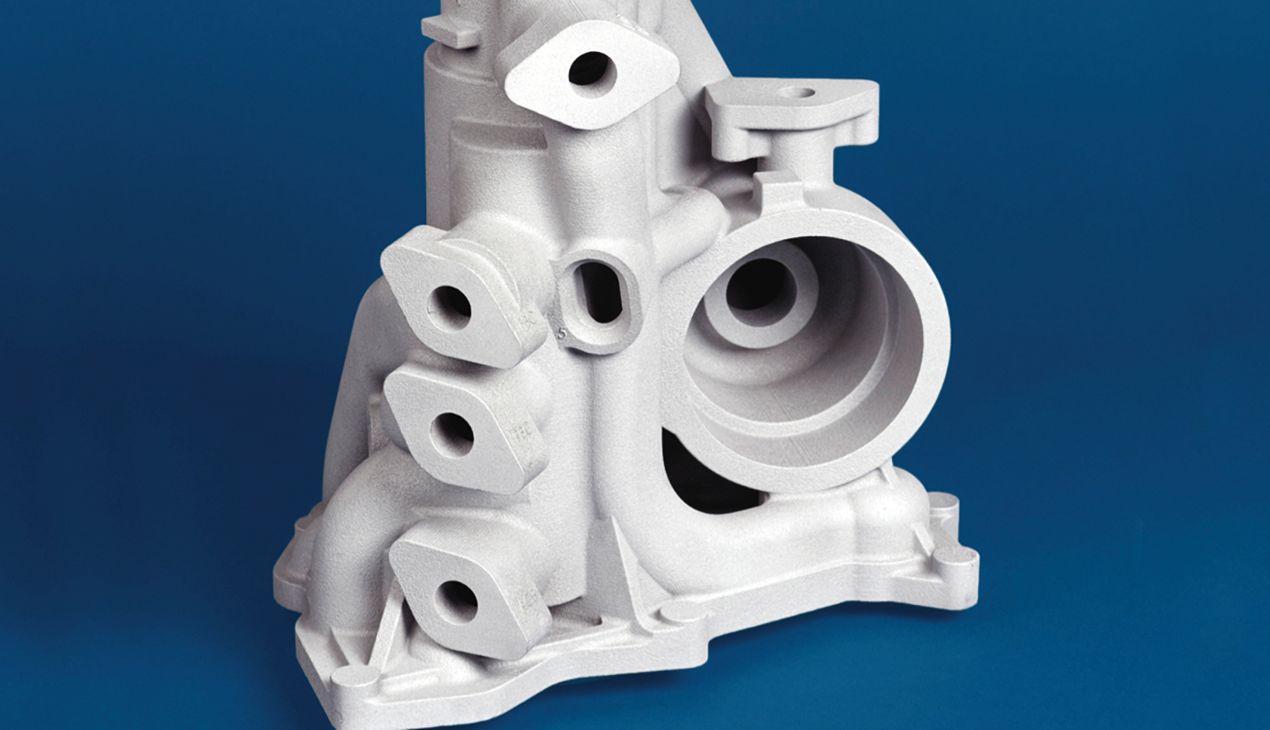

Shellcast Inc. won ICI’s Aerospace Award with a coreless design for a high-pressure valve: aircraft control systems have strict size and weight restrictions, and the high-pressure application also is prone to performance failure due to harmonic pulses.
A typical casting design using pre-formed cores was ruled out due to delivery and to high heat-retention within the core bodies. “By using careful, straight-dipping techniques, our process can achieve high reliability and dramatically reduce internal temperatures during solidification. This allows us to achieve tight NDT requirements in much less time,” recalled quality/engineering manager Gregg Nash.

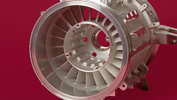

Aristo-Cast Inc. earned ICI’s Automotive Casting Award with its design for a cast-to-size wheel that requires only minimal machining. “Once again, one of our favorite customers came to us with a challenging detail that not only pushed our limits for size, but also took us into a new area in casting …,” explained Aristo-Cast’s Paul Leonard.
“They first came to us with the design that their generative design software came up with, and we had to suggest a few minor changes to create a better investment casting, and with those small tweaks we then designed the gating configuration to be able to feed the part correctly and reduce the amount of machining that would be required to remove this gating,” he concluded.
