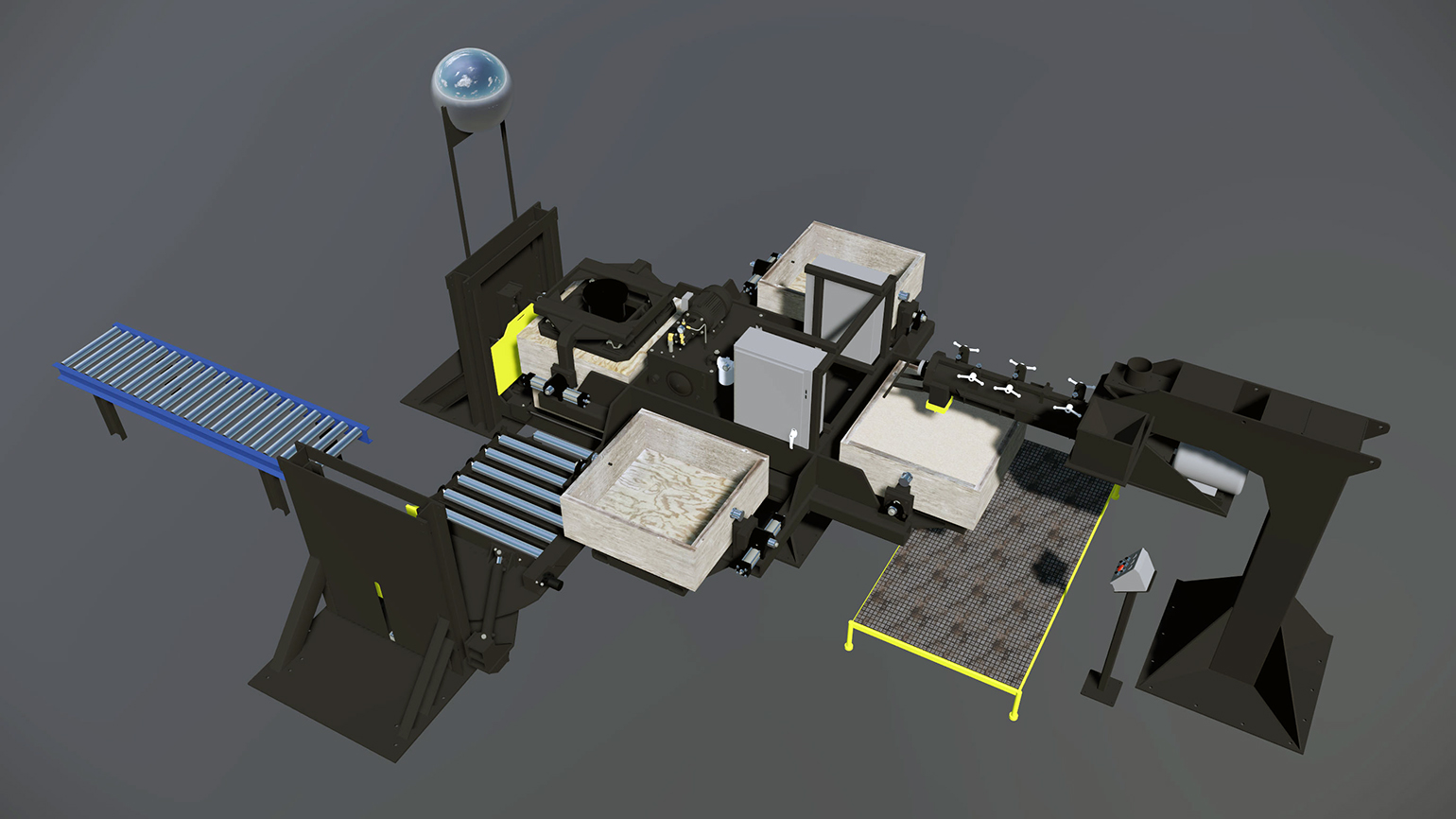

Flip molding machine system — The FMM is a comparatively recent development in chemically bonded mold production systems, in general with four or six stations. A station is a cast iron, Blanchard-ground platen that inverts using a hydraulic actuator.
Operation: The box is fastened to the platen and filled. A vertical vibrator mounted on the bottom of the platen compacts the mold before striking off in place. The system is indexed for one station; the station between filling and drawing is for set-up time.
When the box is at the draw station, the whole platen inverts. A precision draw platform elevates to the mold surface, the retaining pins which hold the mold to the box when inverting are drawn, and the same vibrator used for compaction starts and the draw platform lowers. The draw station is equipped with proof of draw identical to a normal rollover.
When the mold is on the lowered draw table it is quickly moved away while the machine is indexing one station and the platen is inverting back to the fill configuration. The station before filling is the prep station.
Advantages: Capital costs are comparable to the carousel/rollover design, which is much less than the conveyor-based system.
Maintenance costs are extremely low as there is no rollover. Each station, along with the draw table, is its own rollover; the platen is inverted with heavy-duty hydraulic actuators mounted to the platen so that the center of gravity is level with or above the actuator, making the load on the actuator low.
There are no gear boxes, chains, or sprockets (there are only two proximity switches for rotational positioning.) The complete machine is mounted to one heavy-duty slewing ring bearing. The vibration isolators between the structure and the platen are of the omni-directional design, providing isolation in both compression and tension.
The draw table is essentially a precision forklift that is inherently inexpensive and maintenance free. As there is no rollover to take two minutes to cycle, a mold can be drawn in as little as 20 seconds. Proven production rates of 35 molds (70 mold halves) per hour have been achieved for 48×48×24-in. sizes.
Floor-space requirements are the lowest of the three systems listed here.
Disadvantages: A perceived disadvantage is that both a larger mixer and sand conditioning equipment are required because the cycle time is as low as 45 seconds; there can be as little as 35 seconds to fill the box. Though this may be a capital-cost disadvantage, the +250% increase in production easily offsets this cost.
The platen needs to invert over the draw table, making the mixer discharge comparatively high and requiring the operator to be on a platform. While the mixer and sand supply is higher than other systems, this inconvenience is easily offset by the 250% increase in production.
Better sand temperature control is required as the cycle time is 45 seconds to setup and draw the mold.
The catalyst pumping system must be precise, for obvious reasons — There is only one station and 45 seconds to prep the box for refill. If the work requires only sleeves and rods, this should be sufficient. In the case of numerous chills for aerospace work, the system simply needs to run slower in this instance. The prep station will set the production rate.
