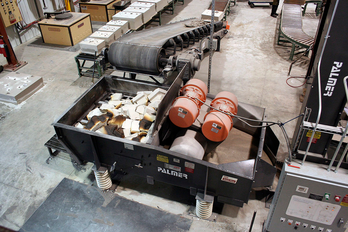

Sand reclamation systems. Sand reclamation involves physical, chemical, or thermal treatment of sand for reuse in molding and coremaking. There are two major types of systems, mechanical and thermal.
A mechanical system physically breaks down lumps of spent casting sand, into clean sand. A thermal reclamation system takes sand that has been broken down to grain size in a mechanical reclamation system and adds heat energy to burn off the remaining resins.
Before sand can be processed in a thermal system, lumps must be reduced in a mechanical system, with the following sequence of components: shakeout deck; attrition mill; elevating device; surge hopper; magnetic separator; agglomerate screener; fluid bed classifier (cooling optional); elevating or pneumatic transportation device; bulk storage silo for mechanically reclaimed sand; and dust collector.
Thermal reclamation system. A typical thermal reclamation system will include the following sequence of components: surge hopper for supply; magnetic separator (if not already included upstream); metered feed mechanism; heating zone; cooling zone; elevating or pneumatic transportation device; bulk storage silo for thermally reclaimed sand; and dust collector (likely high temperature.)
