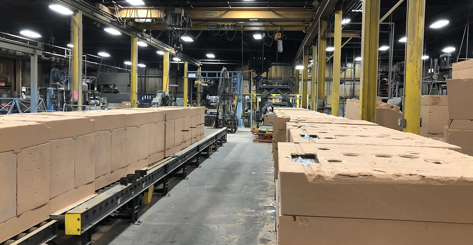

At Eck Industries, as at most jobbing shops, the workflow involved molds for a range of casting sizes and designs. Some jobs involved simple, small cope-and-drag processes, with no core work. Others involved large and/or long molds, with loose pieces, and required placement of substantial sleeves and chills, etc. Palmer recommended a three-phase approach to this project.
Phase 1. Increasing production, decreasing manual labor
To increase production while reducing manual labor, and to increase the number of molds produced per hour, a C–frame rollover molding machine was custom designed. The rollover technique eliminates manual handling of the molds and cores, and the closing step.  Also, because Eck’s work involves producing large and long castings, positioning the molding boxes sideways proved to be the most efficient layout. Filling, compacting, and moving the boxes to the rollover was accomplished by adapting a Palmer mixer and mold-handling conveyors already in place at the foundry.
Normal molds would proceed into the rollover and get drawn, and the empty box would be returned to the molding line, with the mold running straight into the coring and closing lines. Large molds would exit the rollover at 90 degrees from the correct orientation for coring and closing.
For this reason, a customized lift–rotation device was designed and manufactured to receive the long molds. The lift would clear the surrounding conveyors and structural components, rotate 90 degrees, and then would be lowered back to the coring closing line.
To reduce manual handling further, a large scissors lift was placed strategically at the closing line to allow the mold height to be adjusted when being placed and the mold to be closed. Once the mold is cored and closed, it would continue on the system and conveyor level to be moved to the pouring area.

 Labor demand was reduced significantly by adopting the rollover and automated mold-handling techniques, which have created a more manageable system for the foundry.
 The mold production rate has been thereby tripled very shortly after installation.
 Automated handling has increased mold quality and proven to be a safer system for the operators.
