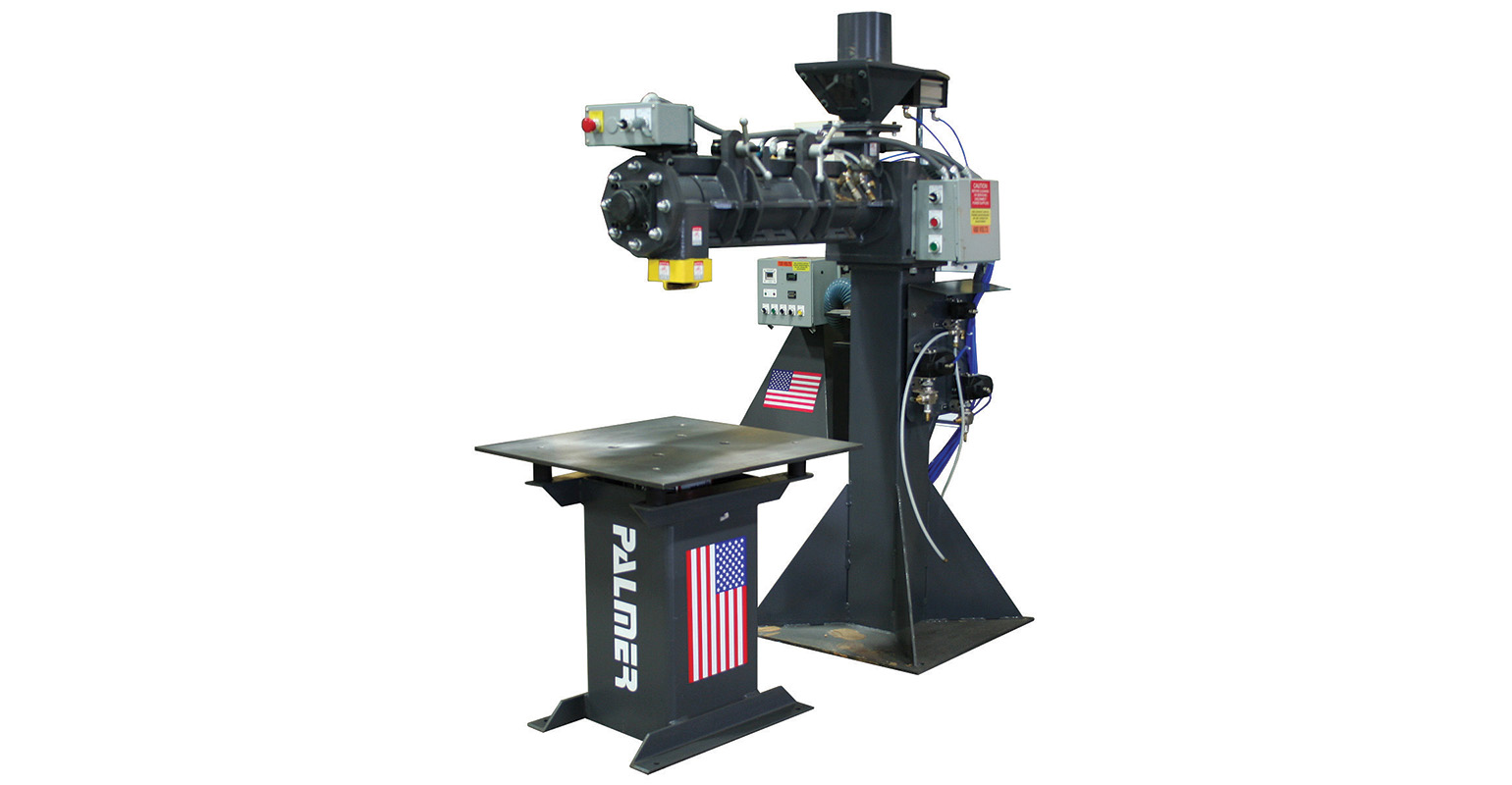

A compaction table with a sand mixer, for improving no-bake molding effectiveness and casting quality.

Rotary vibrators are the most common type of vibrator used for compaction. Rotary vibrators have a limited effect because they cannot provide true vertical vibration, even when there are multiple vibrators counter rotating. A vertical vibrator is more versatile as it can be turned down to a low level to properly compact a small mold or core, and turned back up to properly compact larger work. It is critical to closely match the force output to the weight of the tooling and sand.
High-frequency vibration is important to making quality no-bake molds. Vertical vibrators can be turned up or down without sacrificing frequency. The force output of rotary vibrators can only be changed by changing the speed of rotation, or by the very slow process of changing the eccentrics/weights that create the vibration. Rotary vibrators also are very difficult to stop immediately. Unless the rotary vibrator is stopped immediately, ramping down the process may create low speed (“loping”), which can negate the benefits of the compaction process.
While the force changes so does the frequency; with different frequencies for different weights of work coming across the compaction table; compacting is best done with vibratory vibrators. Achieving consistency using rotary vibrators is nearly impossible when compacting varied weights.
In order to select the proper force setting, it is common to run a “drop-and-stop” test. This is a test where the selected box is filled normally and then struck-off before compaction. The compaction cycle is started with the vibration time set at 5–10 seconds.
If the sand is still going down when the vibrators stop, more force or duration of vibration is needed. If the sand drops and stops before the vibrators stop, less force or duration is needed. If this test is performed on every job, the proper effective compaction settings can be determined quickly. It is not as simple as calculating a force/time setting based on weight, as deep work behaves differently than shallow wide work. In order to keep the compaction process simple and repeatable, it is recommended to keep the duration of vibration the same for all jobs (typically at 5 seconds.)
Documenting the force setting is as simple as writing the force output setting on the box. The compaction table “force output” dial is labeled 0–100%. The tech simply performs the drop-and-stop test and writes the number on the side of the box. Then, when the same box is back under the mixer, the operator runs the correct amount of sand into the box, and turns the dial to the correct setting and presses the cycle start button.
At this point, the airbags inflate lifting the box off the rollers or support structure. Once the box is lifted, the vibrators run at the selected force output for the predetermined amount of time. Once this time runs out, the airbags are deflated, lowering the box back onto the conveyor rollers and, completing the cycle. This typically is a 15–20 second process. Then the top of the mold is the struck-off, moved to the next station and the next job is moved into place.
