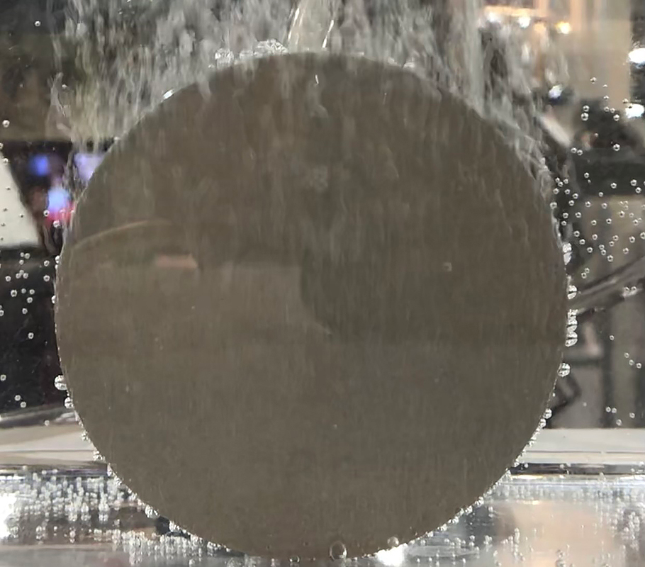

A billet of Vortex® steel can be seen venting in water at 10 PSI.

An age-old problem with molding wax patterns has been achieving proper fill. Molds that do not fill completely will form defective parts. Trapped air, part distortion, cracking, and knit lines are all problems that can be resolved with a self-venting mold steel. Vortex® is a micro-porous steel material, designed to be used in strategic areas of the die, which helps to eliminate many of these common problems, which of course will reduce scrap rates and downtime — all while contributing to production of higher-quality cast parts.
Vortex is a stainless steel alloy that is 25% air by volume, with a pore size that is 7 microns on average and a hardness comparable to 43 HRc. This micro-porous structure allows air to escape, but those pores are too small to allow wax to penetrate. The material is available in various rectangular and round sizes and is adopted especially for foundries producing lost-wax core castings to supply demanding industries, including medical, aerospace, consumer products, and jewelry.
