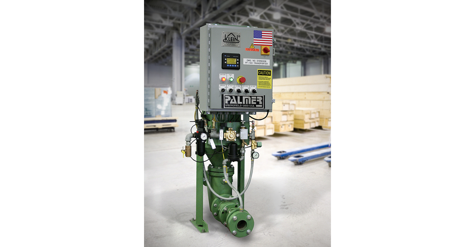

Compressed-air sand conveyance
To overcome the problems of abrasion when conveying sand pneumatically it has been common practice to use large, compressed-air conveyance systems like those commonly found in dense-phase conveying. Blow tanks for these dense-phase systems normally are increased in size to match the required tonnage rates.
All of these large vessel dilute-phase transporter systems, however, have a relatively large number of components that are subject to wear. Also, to reduce cycling frequency of affected components and increase their life expectancy, the largest blow tank for a given capacity is normally specified with an average fill time of 90 seconds or more.
To reduce operating costs of pneumatic transporters, smaller blow tanks with faster fill times (14 seconds or less) have been found to be less expensive to build and require less floor space. When all of the small efficiencies are incorporated into the PlugFlo method, they favor lower compressed-air consumption (of up to 45%) and use of more cost-effective, Schedule 40 pipe.
To eliminate pipe movement during operations, use solidly anchored pipe supports. Pipe and bend connections should use special-bolted flanged arrangements, eliminating any gaps between pipe ends and never use butt-welded, pipe-to-pipe connections.
After installation, the pipe run must be pressure-tested to verify that there are no leaks.
Only trained professionals should manage installation and startup. Adjustments to the air volume and pressure, if required, should be made with a clear understanding of the possible results and capacity of the system. Incorrectly changing of these settings on dense-phase systems can turn the system into a dilute-phase process – in which all advantages discussed here are lost.
