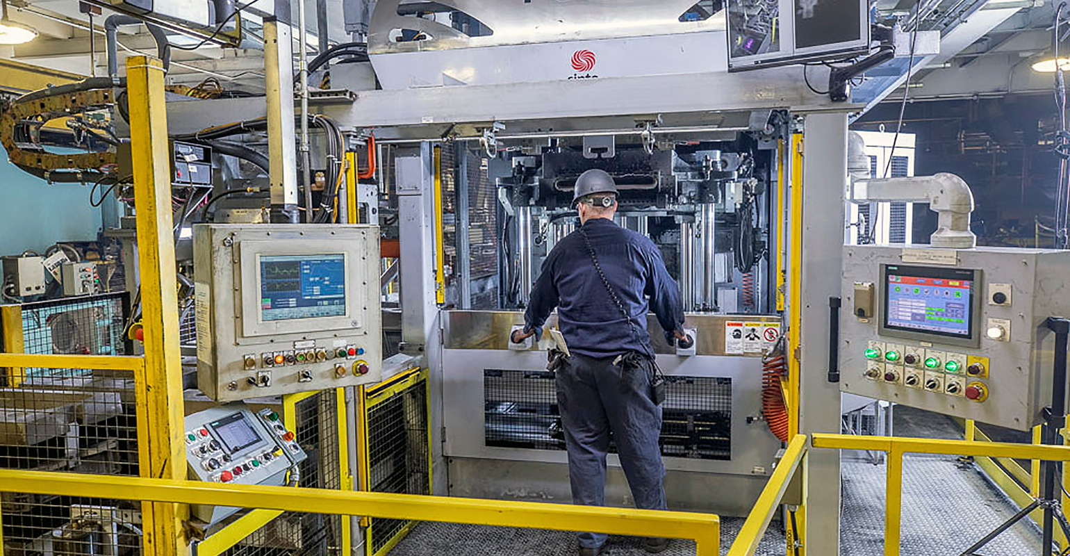

A Sinto America FBO flaskless molding machine for horizontally parted molds installed at Waupaca Foundry Plant 1, Waupaca, WI.

Waupaca Foundry staged an inaugural event recently to mark the ‘first pour’ for a new molding line at Plant 1, its gray iron foundry in Waupaca, WI. Construction for the Sinto America horizontal molding system began in February, in “direct response to customer demand,” according to Waupaca Foundry president and CEO Mike Nikolai.

The Sinto line is the first horizontal molding line for Waupaca Foundry – long known for its reliance on high-volume green sand vertical molding operations. The new operation is capable of 200 molds/hour production, with 18-sec cycle time for pattern changes, automatic core setting, and laser-guided automatic pouring.
Waupaca Foundry noted it will be able to adapt existing matchplate tooling “of equal or smaller sizes”, for customers working to meet production schedules.
