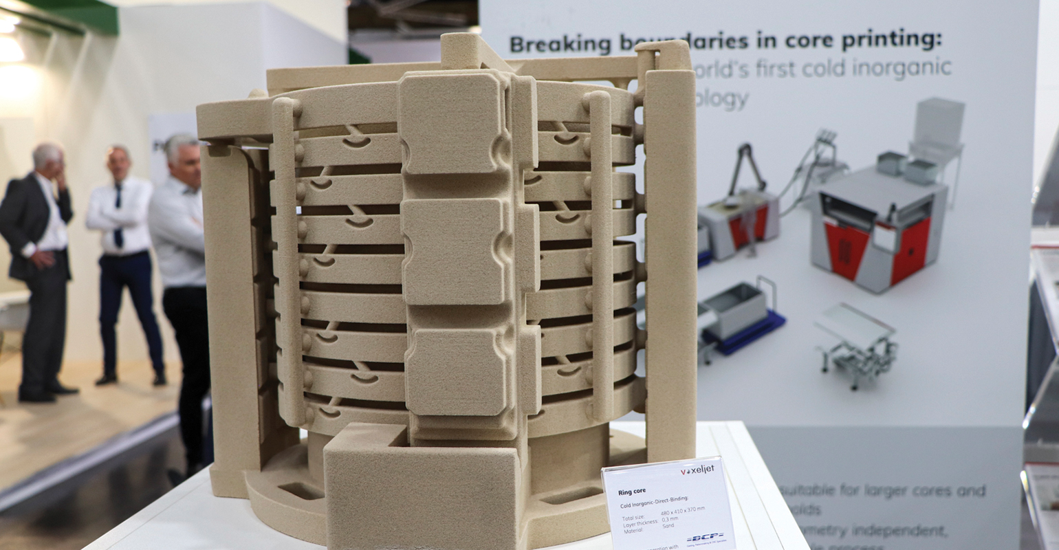

The high-complexity sand core for a water-jacket casting, 3D-printed by voxeljet using its cold-curing inorganic binder (cold IOB) technology.
