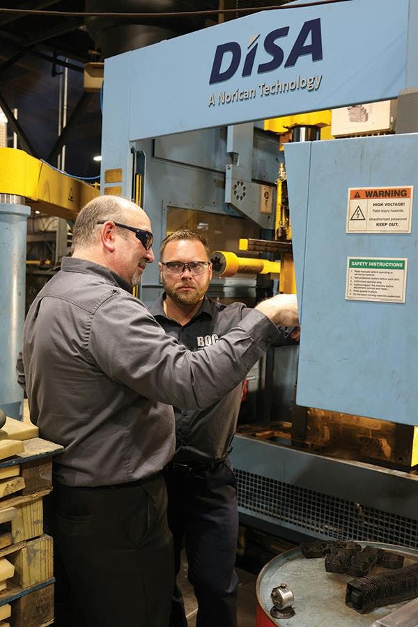

Boose Quality Castings in Lebanon, PA, installed a DISA MATCH 16/20 machine at its aluminum foundry, which has been a transformative decision. The change has reduced scrap rates considerably, and also improved the surface finish of castings, leading to substantial labor cost savings. BQC operates three molding lines, all of them fed by a single 100B Speedmullor that can mix up to 100 tons of sand every hour. All the castings are all gravity poured, mostly by hand but at times by a robot.
Seeking higher-quality aluminum castings, v.p. of Operations Brandon Boose decided to replace the foundry’s former molding lines with new machines. There were several other quality-related investments in melting, melt hydrogen level testing, and mold handling too. Two years into operation, the higher-quality molds have improved Boose’s ability to produce aluminum castings with high dimensional accuracy and excellent surface finish.
Running the old molding lines, the foundry consistently recorded weekly scrap rates of 4-5%. Even running at higher speeds (up to 187 molds per hour) the new machine’s scrap rates are less than 2% in an average week, for the same product mix.
A bonus for BQC ‘going green’ has been the cost savings. The new line’s green-sand molds produce a fine surface finish in the final casting, typically around 300-325 RMS (AA-CS-E18-92); Products with releases or very tall risers can come close to 250 RMS.
What’s more, Brandon Boose explained, is that “there’s far less fettling and grinding required to satisfy our clients’ surface-finish requirements, which has reduced our labor costs significantly.”
Intricate pattern designs that the foundry previously struggled with have become a lot easier to produce, too. Rather than being forced to put sand in the cope wherever there were pockets, BQC operators just blow the mold. Tooling costs are low compared to diecasting, and this makes prototyping much faster and inexpensive too, as green-sand tooling is over 90% cheaper compared to permanent molds, and each plate has a performance life that’s now about six-times longer.
A low-alloy-steel DISA MATCH plate can create up to 500,000 green-sand molds, while a permanent mold made from the same material typically will only last for 70,000 gravity diecasting shots. BQC’s most heavily used tooling has so far made 20,000 molds with no detectable wear.

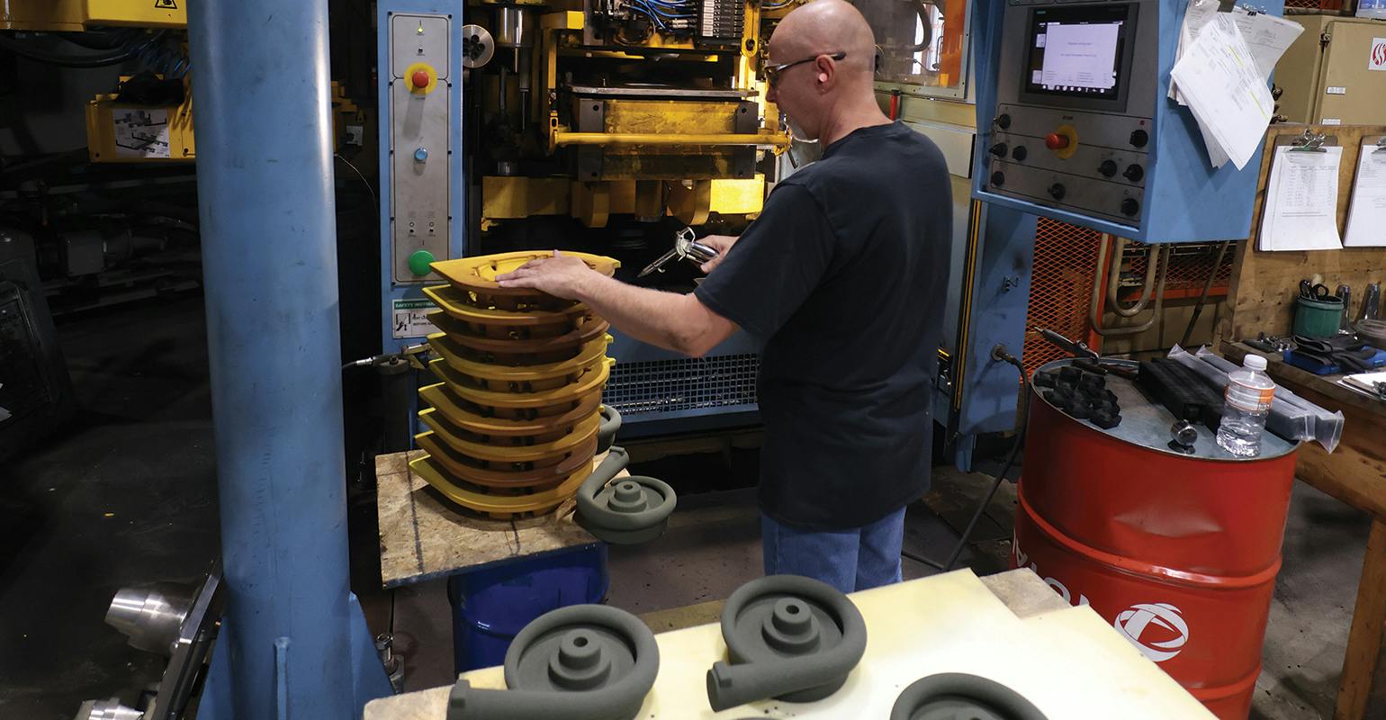

The DISA MATCH 14/19 machine has assumed a central role at Ford Meter Box in Wabash, IN, bringing notable production advantages for casting brass hardware for water systems. Together with an automatic core setter and cutting-edge digital capabilities, Ford Meter Box is maximizing the quality of its brass casting, and increasing productivity at the same time. It achieved both these while streamlining maintenance processes.
Because many of the castings are produced to carry water, Ford Meter Box needs to set a lot of cores to form the required channels. Unfortunately, its legacy molding machines required manual core-setting, which made cycle time and quality very dependent on operator skill and the size and number of the cores involved.
A DISA MATCH machine with DISA’s Automatic Core Setter was selected to improve brass casting quality and productivity. The result: higher and more consistent brass casting quality, minimal machine mismatch, and the eradication of manual core-setting errors, such as finger holes in the sand. Molding and auto core-setting speeds have surpassed expectations, enabling them to swiftly complete short runs in a working week.
The integration of digital features amplifies the efficiency of the green-sand process. Modern machines like DISA's MATCH incorporate digital functions for data collection, analysis, and recipe management. This ensures optimum machine settings for each pattern, and contributes to consistent mold quality, reducing errors and enhancing the overall work environment.
