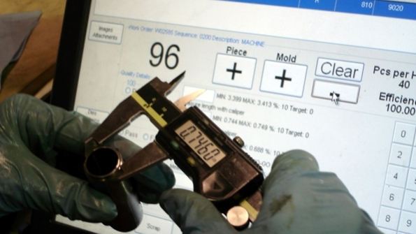

To compete, foundries must be able to provide real-time intelligence on production metrics to show the location of every piece in production, what every member of the staff is doing, the quality of every piece, and what is happening on the plant floor to meet each order — a hard thing to do on the back of an envelope.

From tracking customers to providing current and historic volume measures, Craft Cast’s ERP system allows it to track and record exactly the kind of quality they are achieving and everything that goes into achieving it.
