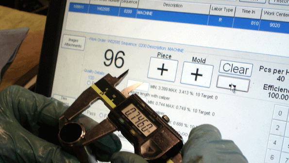

Craft Cast an investment caster introduced an ERP module to manage production flow in its machining operation Instructions displayed at the work station allow dimensional details to be recognized in real time on the first substandard workpiece

It provides a roadmap for optimized production and allows foundries, even small and midsized companies, to stock up and meet orders for major customers on their schedules, he said. “ERP forms a discipline in your company,” said Al Scargall, president of investment caster Craft Cast Co. Inc. “Once you put it in place, you know where everything is, you know the stage it is at, you know the costs of where it’s at, and it helps you work through your process.”
Basically, he said, “it’s just one hell of a major tool that really allows you to understand your business.”
From tracking customers to providing current and historic volume measures, Craft Cast’s ERP system allows it to track and record exactly the kind of quality they are achieving and everything that goes into achieving it.

Over the last 3.5 years, Scargall said, this kind of insight has helped him bring Craft Cast’s scrap volume down from 14.5% to 4.5%.
