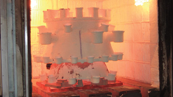

Over the past two years, it has been proven that modern, high-speed 5-axis machining systems are ideally suited to the production of precision polystyrene patterns, large or small.   To date, ceramic molds have been produced on numerous machined patterns up to a nominal maximum size of 2 x 2 x 2 m, with a target of 2.5 x 2.5 x 2.5 m within Cti’s sights.  The point has been reached where just 10 coats of ceramic are used on even the largest of shell molds, and these have proved capable of enduring the thermal and mechanical stresses associated with pouring up to 2.5 metric tons of molten steel (the limit of Cti’s melting capacity.)
Developments are underway that are likely to reduce the number of coats from 10 to eight, resulting in lower costs, higher productivity and lighter molds.  Indeed, a measure of the challenges faced in this development is the weight of such a shell mold, the largest so far being more than 300 kg.
Cti has had to overcome handling and other issues in order to bring this technology to a level of functionality and cost competitiveness that will ensure its adoption.  The measure of progress toward this objective is the success in licensing the technology, registered as MEGAshell®, to five companies (one of which is using it to produce very large titanium castings. There are further discussions underway with a five more potential licensees.
Supplying ceramic molds
Soon, foundries in the U.K. will soon be able to take advantage of the MEGAshell technology by Cti supplying ceramic molds for them to pour, in the same way that Cti has provided a service to foundries by supplying vast numbers of rapidly printed precision sand molds and cores for more than six years.  Thus far, nearly 100 large ceramic molds have been shipped more than 100 miles to a third-party foundry in the U.K., none of which have been damaged during transport or handling at the foundry.  Also, all the molds made at Cti’s site on the Advanced Manufacturing Park in Rotherham have been transported by road to the company’s original site in Sheffield to be poured without any problem.
