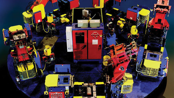

Turntable semi-permanent, vertically parted molding — Design changes to these system over several years have improved operations, reliability, and maintainability to meet current production requirements. Some manufacturers’ turntable systems use five casting benches arranged around an electric motor-driven turntable, with a diameter of about 26 ft. A system like this is designed with a minimum platform height of 39 in., so there is no need for a casting pit with such an installation.
Turn, Turn, Turn
Some of the standard design details of semi-permanent turntable molding systems are a 10-position table, with positive locator shot pin; five modular benches, accurately located and leveled; and tooling sizes up to 38.25x41.375x30.75 in. (WxDxH).
Functional details of these installations may include a modular bottom ejector, or angled ejectors; individual dual end pulls, or optional side pulls; a cope cover strip cylinder; and accessible tooling cylinder locks. The electric turntable drive system powers a five-piece construction, with a diameter of 26 ft., and a vertically actuated cylinder swing arm assembly. The system’s access plates are removable, and the water-cooling system is controllable. Lubrication is an automated function.
For such a system the typical mechanical dry cycle is 75 seconds/station. For a typical solidification, depending on a particular customer’s tooling package, a production rate of 48 castings per hour may be expected.
A complete, turnkey set-up of such a system would include ancillaries like a furnace; pouring/ladling gantry; machines for core setting, extraction, and degating/deburring; and conveyors for taking away finished molds.
Conventional, semi-permanent, vertically parted molding — Similar to an automotive turntable system, which is associated with cylinder head production, a turntable system for horizontally parted molding is simplified, and flexible enough to run a wide range of parts typical to most production foundries. The “tilt back after pouring motion” can be included with these machines, if desired. Water-cooling and thermocouple controls can be include too, according to customer-specific requirements.
These turntable systems are available in a common, eight-station model, customizable upon request. Although similar in design to an automotive series of turntable systems, the same effort in design capabilities, reliability, and maintainability have been incorporated.
Among the standard design elements are the eight-position, electrically driven turntable with positive locator shot pin, and eight modular benches, accurately located and leveled. The turntable is a modular installation, with no need for casting pits.
The tooling size is up to 44x29.5x24.375 in. (WxDxH). The system has loose piece controls, and a centralized distribution for all utilities.
