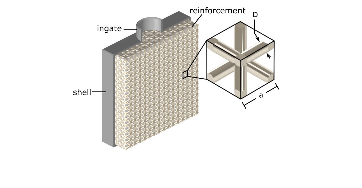

In details reported by the researchers, the two materials they combined were stainless steel and aluminum. Their two-stage process "infiltrates" a 316L stainless steel lattice structure with a molten aluminum alloy, A356. According to their report, the process helps to overcome "issues with intermetallic formation, cracking, and poor resolution" that are common in many metallic parts formed by standard additive manufacturing.
The first step developed by the Oak Ridge team involves producing a lattice preform structure in the stainless material using selective laser melting, an established metal additive manufacturing method. The lattice structure then is the framework of the finished part.
Researchers modified the shape and density of 3D-printed lattice structures
to achieve desired material properties in composite metal castings.
Dual material components were created by pouring an aluminum alloy over a printed stainless steel lattice, and the results showed significantly improved damage tolerance than a simple aluminum part.
In the second step, the frame is set within a permanent mold and then surrounded with a liquid metal at a melt temperature lower than that of the inset framework. The molten aluminum fills the space around the frame within the mold, and the resulting part is described as "interpenetrating phase composite" (IPC) that has a higher tolerance to damage than a comparable aluminum casting.

Compression tests conducted on the stainless steel/aluminum part showed that adjusting the volume fraction and topology of the stainless steel lattice can control its stress-strain response. Also, according to the researchers, tension tests on composites with a 39-vol% of steel demonstrated "an order of magnitude improvement over the strain to failure" compared with the aluminum alloy on its own.
"Inspection of the as-tested tensile specimens suggested that this exceptional damage tolerance is a result of the interpenetrating structure of the constituents," the researchers wrote. "These results together demonstrate that this infiltration processing route avoids problems with intermetallic formation, cracking, and poor resolution that limit current fusion-based additive manufacturing techniques for printing metallic composites."
