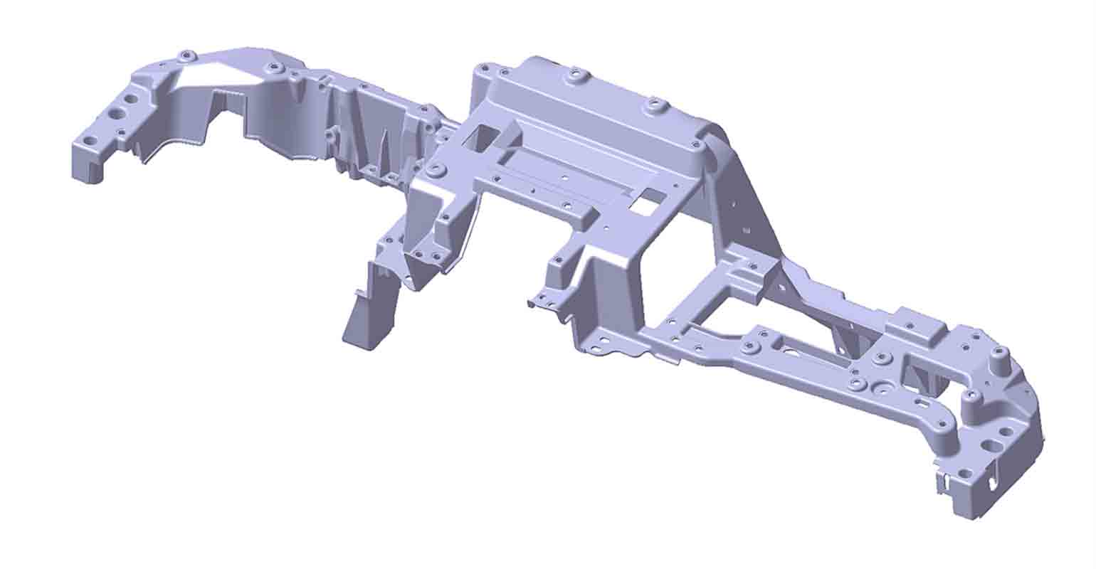

diecast magnesium instrument panel crossbeam

The Eaton Rapids plant is one of the North American auto industry’s largest suppliers of lightweight structural parts — engine cradles, front-end carriers, instrument panel crossbeams, liftgate inner structures, and radiator supports.
