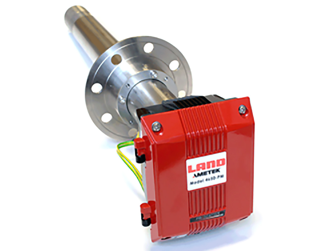

The AMETEK Land 4650-PM is a stable and accurate, low-range particulate matter measurement system designed for CEMS applications where condensed water is not present in the flue gas. Consisting of a stack-mounted probe and separate control unit, 4650-PM’s forward-scattering laser measurement detects particulate matter at low concentrations. This enables closer emissions control, with a more accurate measurement than similar PM monitoring systems.
Maximum measurement stability is achieved by the 4650-PM thanks to an advanced optical system with a lower angle of incidence than competing systems, resulting in a lower detection limit, while the optics are fixed for measurement reliability.
The 4650-PM meets US-EPA Performance Specification 11 (PS-11) and is suited for users who must comply with US EPA rules, including MATS and Boiler MACT.
The 4650-PM has a superior calibration check mechanism and is less susceptible to changes in particle size, which is required where accuracy is critical. It provides a highly sensitive measurement and is capable of measuring concentrations from 0.01 to 200 mg/m3. Offering the highest stability and reliability, 4650-PM can be used in stack temperatures up to 500°C / 930°F.
