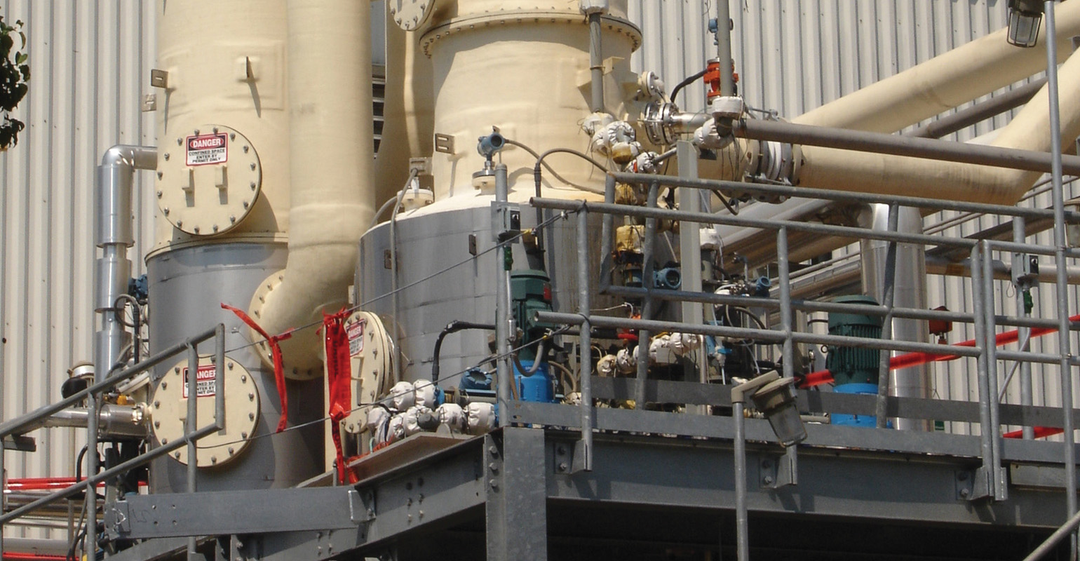

Cost-effective, "packaged" systems are available for batch or continuous operation, semi- or fully automatic operation, along with pre-treatment options, standard or specified instruments, controls and mechanical components, and more.
BIONOMIC INDUSTRIES INC. released its new ScrubPac custom skid-mounted scrubber system, a cost-effective, "packaged" system engineered to meet customers' specific requirements for process emission control. All necessary components — recirculation pumps, piping and valve networks, exchangers, instrumentation, controls, and any other essential items needed to satisfy customers' applications are included in the system.
Systems are available for batch or continuous operation, semi- or fully automatic operation, along with pre-treatment options (high-temperature gas quenchers, VOC condensers, super saturators for fine particulate capture), standard or customer-specified instruments, controls and mechanical components, local or remote system control/monitoring, and special spill containment skids and modularized, skid-mounted assemblies for large system hard-to-fit spaces.
Factory-assembled, run-tested, and operational when they arrive on site, the systems require only process and utility connections and are available for gas capacities from 100 through 150,000 acfm.
Typical applications include VOC scrubbing, nitrogen-oxide, hydrogen-sulfide and organo-sulfur compound removal, acid and ammonia scrubbing, halogens and amines removal, aerosol removal, fume and gas scrubbing, and mist removal. Learn more at www.bionomicind.com.
