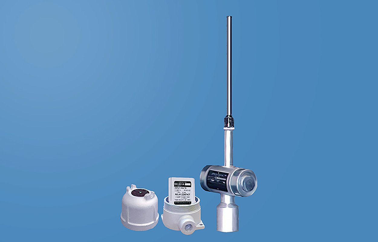

Easily obtain accurate measurement for molding sands, green sand, reclaimed sand or other bulk solids materials.
AUTOMATION PRODUCTS INC. – DYNATROL® DIV. DJ level detectors have been successful as plugged chute detectors for most types of material conveying. They are also ideal for high-point level detection providing dependable operation in dusty environments as well as on vessels, storage bins or hoppers equipped with vibrators. Easily obtain accurate measurement for foundry molding sands, green sand, reclaimed sand or other bulk solids materials ranging from low density flakes and powders to pellets and heavy granular materials.
These level detectors are virtually wear-free: They contain no moving parts, gaskets, or seals, and rely on mechanical oscillations to determine if the probe is covered or uncovered.
Signals from the Dynatrol® DJ level detector operate a single-pole, double-throw relay within the control unit, and the relay contacts actuate alarms, indicator lights, or process control equipment. The units are factory-calibrated with no field calibration required.
Dynatrol® point level detectors are constructed for a long operating life and have proven reliable in factory use. They are approved for Class I, Groups C and D; Class II, Groups E, F, and G; and Class III services. Learn more at www.dynatrolusa.com
