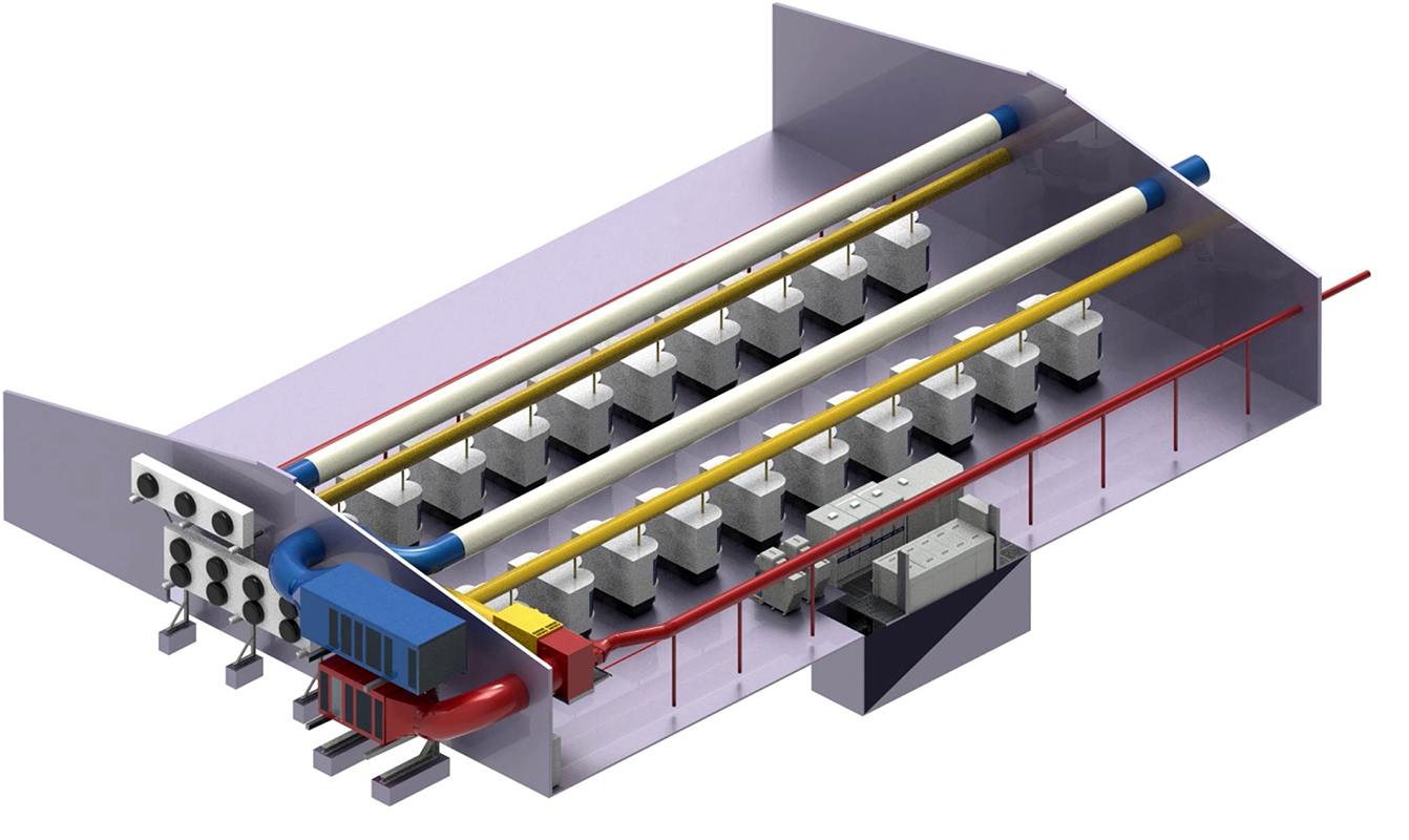

The LBG air-handling unit guarantees 100-percent air exchange and uses residual energy from production and peripheral systems to heat/cool the plant atmosphere.
Recently VOMAT introduced a new air-conditioning unit that converts excess energy from production and peripheral machines – e.g., grinding machines, oil extraction systems, machine pumps, etc. – and can then use that energy to heat or cool the plant atmosphere via the air conditioning shafts, with an accuracy of +/- 1 degree Celsius.
"Our new full air conditioning system consists of a central exhaust air-extraction system and a fresh air supply unit,” explained Steffen Strobel, technical sales manager at Vomat. “On the one hand, this ensures 100-percent air exchange with optimal air distribution in the production area without recirculation.
“On the other hand,” he continued, “the system is designed in such a way that exhaust air heat, for example, as well as existing residual energy in heat pump operation can be used for both heating and cooling - and this is up to 60 percent more energy-efficient than conventional air conditioning systems."
In addition, there is the option of regulating humidity or dehumidifying the air in the rooms to be air-conditioned. Vomat manufactures customized solutions ranging from standard solutions to special complete solutions.
