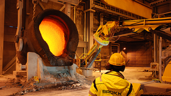

The Brokk 800P is equipped with a specially designed process breaker that will withstand high temperatures as in cleaning hot ladles
Robot for Hot Ladle, Converter Cleaning

Brokk specially designed the 800P with added heat protection for use in challenging process applications. It includes an extra-durable, heat-protected SB302 hydraulic breaker to work with hot ladles, runners and furnaces, and the machine delivers 450 foot-pounds of force at the tip of the solid-body hammer. The Brokk 800P’s three-arm system rotates 360 degrees to reach challenging angles with precision, and offers an impressive reach of 31.5 feet.
The Brokk 800 machines feature the same compact design and power-to-size ratio as all Brokk units, for effective work in smaller, more restricted spaces. They are powered by 60-horsepower electric motors for safe, emission-free operation in confined areas, or can be equipped with diesel engines. Like all Brokk machines, their remote-controlled operation allows operators to remain a safe distance from work so there is less risk of injury from hazards such as high heat and falling debris.
