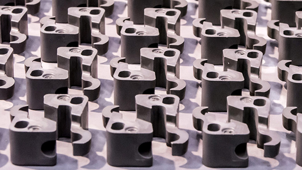

Recently, Linde LLC introduced the Sinterflex® Atmosphere Control System (ACS) for carbon control in sintering of metal injection-molded (MIM) parts. The developer claims the process effectively doubles the number of parts “in-spec, resulting in significant improvements in quality, productivity, and profitability.”
The powder metal process combines the precision shape-forming advantages of plastic-injection molding with the strength and durability of metals. The final step in MIM is sintering, the high-temperature hardening process that fuses the high-density alloyed powders by applying heat below the melting point in a controlled atmosphere.  By establishing a carbon-neutral atmosphere during sintering, MIM parts avoid decarburization, a frequent problem that prevents the carbon content from being in specification.
