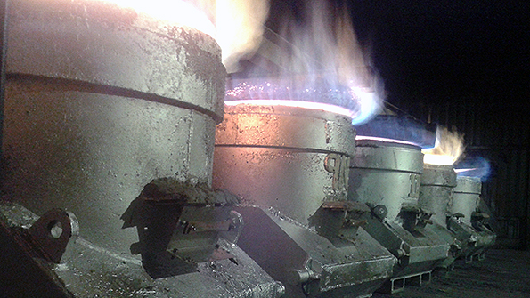

The Ladle Trackertrade technology was tested and commissioned at the Tupy foundry in Saltillo Mexico the developers noted

Compacted-graphite iron production process developer SINTERCAST A.B. launched a monitoring technology to track and record the progress of each ladle as it progresses through a foundry. The Ladle Tracker technology was tested and commissioned at the Tupy foundry in Saltillo, Mexico, the developers noted.
In the SinterCast Ladle Tracker process, a radio frequency identification (RFID) tag is affixed to each ladle and RFID reader antennae are installed at critical locations throughout the foundry, such as furnace tapping, treatment stations and pouring.  The system documents the time of the ladle at every position; ensures that every ladle reports to every step in the process; and, ensures that each step is completed within the allocated time.
Peripheral information can be incorporated into the process database, including temperatures, ladle weight, wire-feeding results and chemistry.
The flexible hardware platform can be configured to suit the layout, process flow, and production volume of any type of foundry, for casting iron or any other metal, SinterCast noted.  The main features and process opportunities of the Ladle Tracker technology include:
