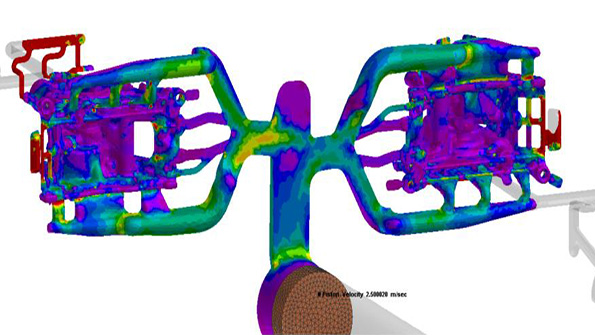

ProCAST 2016 graph depicting Pressure (P)—Flow Rate (Q)², as seen in ProCAST 2016, showing the operating point and operating zone on a Colosio PFO 750 high-pressure diecasting machine.

Another notable enhancement to ESI ProCAST 2016 is the introduction of the machine selection workflow that draws on a dedicated database for high-pressure diecasting (HPDC) machines. The new functionality enables the user to define the operating point and operating zone for any machine, using the Pressure (P)-Flow Rate(Q)² graph. This information is linked to ProCAST's solver to achieve virtual piston control in real time. Enabling a user to set-up parameters just as on the actual machine, this enhancement provides a considerable time gain for process-design, and delivers the possibility to run a virtual benchmark and select the appropriate machine for specific jobs.
