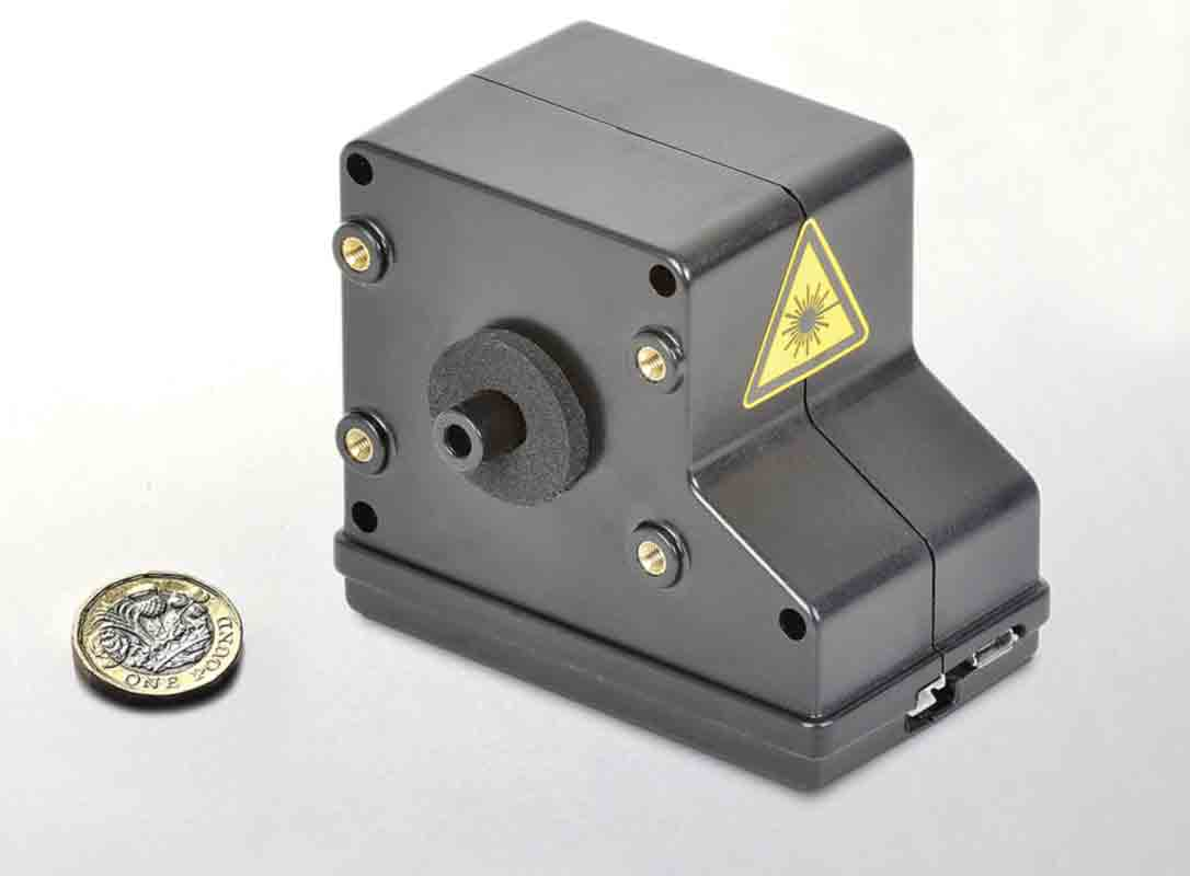

New-design optical particle counter adds automatic range-switching capability
ALPHASENSE launched a new version of its OPC-N3 optical particle counter, with all of the advantages of the predecessor model plus automatic range-switching capability covering PM10, PM2.5, and PM1. With an expanded measuring range (0.38 to 40 μm), the OPC-N3 is able to measure the particulate fractions of most interest; from the finest of particles up to larger particles such as pollen. “This is an extremely important development for manufacturers of air-quality monitoring instrumentation,” says Alphasense Director, Arthur Burnley.

The OPC-N2 was originally developed at the Centre for Atmospheric and Instrumentation Research at the University of Hertfordshire. Over the following five years, the product was refined through a collaboration between the University and Alphasense. The sensor has also been proven in the field, including for example, the capture of more than 150 million readings at London’s Heathrow airport. The OPC-N3 measures particulates accurately, repeatedly, and with minimal maintenance using a patented design, providing both particulate matter readings and real-time particle size histograms. As such, the sensor competes in performance with existing analytical units but at a fraction of the cost.
With the OPC-N3, Alphasense has offers a more rugged design of the OPC-N2, with the same dimensions and power/ interface as the N2. The OPC-N3 now measures from 0.35 μm to 40 μm, sorting into 24 size bins.
Features include improved aerodynamics with reduction of particle deposition; better low-end performance; extended upper size measurements and high/low flow-rate digital selection. The OPC-N3 can measure from clean rooms to pollution levels to 2,000 μg/m3 with the novel feature of being able to size speciate pollen.
