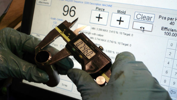

Within the routing sequences of a manufactured part, the “key output variables” are defined to the system as quality attributes.  Each attribute can be defined as either qualitative (pass/fail), or quantitative with upper and lower control limits (min/max).  When an attribute is quantitative, inside of the upper and lower control limits, the user has the ability to define alert limits.  These alert limits provide the ability to notify pre-defined personnel when the specific Output Variable is nearing out of control.  Detailed instructions on how to perform the quality checks along with drawings, pictures and/or videos should also be attached to the routing sequence.   Variability in performing quality checks among operators can be controlled by providing clear instructions and proper training for all individuals performing these tasks.
Input Variables also should be defined at the routing sequence level.   Key process input variables are process inputs that have a significant impact on the variation found in a key process output variable. That is, if the key process input variables were controlled (e.g. held constant), the process would produce predictable and consistent outputs.
At time of production, touchscreen data collection stations on the shop floor, display the Input Variables and related documents designed to control the production process.  These stations also have the ability to capture the results of all quality checks (Output Variables.)  From this real-time data reporting, run charts can be reviewed to monitor trending in Output Variables.  If the reported Output Variable is quantitative and outside of the alert limits, a message is sent to defined personnel.  If it is outside the upper and lower control limits, proper attention may then be given to corrective actions.
