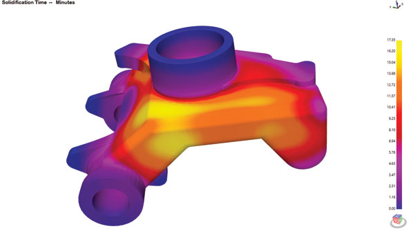

“Naked” simulation — The first step in the rigging process is to run a simulation of the part ‘naked’, that is, without any rigging system. Simulation results show the effects of the part geometry on the overall solidification. In this initial simulation, filling analysis typically is not done, which allows extremely rapid results and can point out preferred gate and riser locations, which would promote directional solidification.
All that is required for the initial simulation is a casting model, normally provided by the customer in STL file format, and basic process details such as casting alloy, mold material, and pouring temperature.

For shrinking alloys, the software uses the progression of solidification, along with a pattern recognition algorithm, to determine the separate feeding paths on the casting. Further, the software can locate the last points to freeze on each feeding path, which will be the preferred riser contact points.
