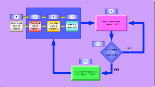

A proper maintenance reliability system addresses seven basic concerns about automation system maintenance 1 it categorizes the types of failures 2 identifies risks of future failures 3 tracks occurrence of failures 4 proposes and manages the methods for detecting failures 5 identifies and initiates the correct maintenance option for the type of failure that is determined 6 assesses feasibility of the selected option as well as countermeasures and 7 evaluates the results of the maintenance approach that is

Maintenance reliability
A correct maintenance reliability system has several components:
Type of failure: The maintenance reliability team shall work together to identify the types of failures.  Correct types of failures must be identified in order to select an accurate maintenance option. This is a crucial step toward making the equipment more reliable.
Risk of failure: The team must determine the risk of the failure. What happens if the piece of equipment fails? Does the failure cause environmental or safety issues, or does it cause major downtime or product rework?
Failure occurrence: The maintenance reliability team shall determine the frequency of the failure, meaning how often the failure occurs.
Current method of detection: Currently what method is being used to detect the initial issue, prior to the final failure? Meaning, is there a way to detect this failure before it occurs?
Maintenance option, or counter measure: The maintenance reliability team shall implement the correct maintenance option for the determined type of failure. The chosen option is the maintenance plan to eliminate, prevent or reduce the consequence of the failure.
Maintenance options could be one or a combination of the followings:
• Time-based maintenance
• Event-based maintenance
• Condition-based maintenance
• Redundancy
• Operational procedures
• Training (operation, or maintenance)
• Maintenance procedures
• Redesign
• Continuous monitoring
•  Run to failure
Feasibility: Is the countermeasure feasible? Is it possible to implement the fix, or is it financially viable? In many cases, our first option might not be practical, and we should choose another option.
Results: How do the countermeasure effect steps 2, 3, and 4? Should the countermeasure become a permanent fix or do we need to re-examine it?
