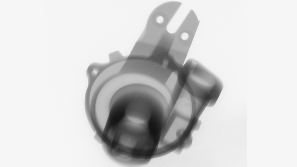

A microfocus computed tomography (CT) system developed by Nikon Metrology is being used by a BorgWarner auto parts plant in southwestern Poland to improve research and development of cast iron turbochargers it produces for passenger cars, light trucks, and commercial vehicles. The 450-kV X-ray equipment penetrates dense materials needed in cast products of this type, allowing the internal structure and quality to be inspected non-destructively.

“In castings, for example, it is possible to ascertain the location and size of a void or crack emanating from it and determine the likely cause of the fault and whether it is due to the type or quality of the material or the component design,” according to Krawczyk.
“Also a bearing assembly can be X-rayed to check that all components are present, avoiding the cost of dismantling,” he continued. “The electron-beam weld that joins an impeller to the shaft can be inspected to check for porosity and mechanical integrity, a job that is impossible to do by visual inspection.”
