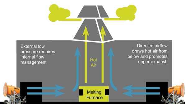

The cannons were located at opposite ends of the plant directing airflow down the center

Positive airflow and Bernoulli's principle — The production rooms are actually four separate, unconfined areas that share a central passage in two rows, leading to openings on either side of the facility. The walls of the building have vents with slowly turning fans drawing air into the 350,000-ft3 (9910 m3) space, and a 150 ft2 (14 m2) pitched roof vent on the ceiling that exhausts the hot air.
Wind is one essential element of creating positive airflow in rooftop venting systems.  The action of horizontal wind pressure across a vent is expressed in Bernoulli's principle of flow dynamics, which explains how air exhaust can induce the compression and expansion of air indoors.
At TDC, the absence of consistent airflow across the vertical roof vent during the summer created negative pressure.  Heated air would build up at the ceiling, causing the pressure on the inside to exceed that of the outside and preventing it from being properly exhausted.  This allowed stagnant air to get trapped in pockets, raising the ambient temperature throughout the plant.

“We set the cannons at both of the entrances on opposite ends of the facility and pointed them at each other, so they could create a directed airstream down the central aisle,” Guthrie explained.  “The stream pulled the stagnant air with it to the center of the room, where rising heat from the furnaces directed air to the vent, creating positive flow upward from the ground.”
The KoolBoss is designed with a 7.5-hp fan, set in the rear of a specially engineered cone-shaped steel barrel, with the fan blades shielded by a heavy mesh guard.  The unit draws air from the wide opening in the tail and forces it down the cone toward the narrower mouth in front, where the shape increases the air velocity and directs the discharge. Mounted either on a mobile carriage or a square steel tube skid, the golf-cart sized unit weighs approximately 800 lb. and can be relocated easily wherever it is needed.
The units were run 24/7 over a three-month period, without disruption and only the occasional position adjustment.  Operators report that the units pulled air from the entrances and delivered a strong airflow that extended down the length of the work aisle and prevented hot air from forming into pockets, boosting positive flow out of the roof vents.  The circulation lowered the overall temperature of the facility and created a more controlled and comfortable work environment.
