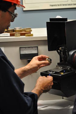

Testing should be carried out regularly at all stages of production, and potential customers should be able to observe elements of this taking place when they visit of a prospective foundry supplier.

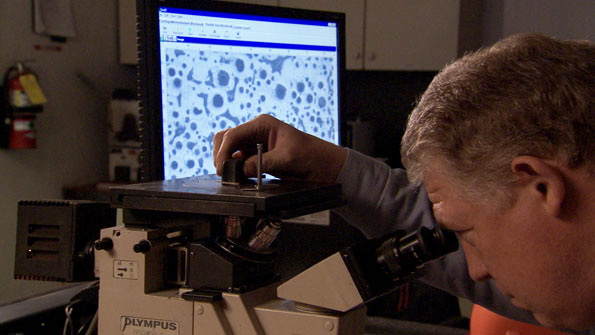

Testing ductile iron requires sophisticated equipment, including spectrometers and carbon analyzers, as well as the regular extraction of samples during production. Nodularity and carbide solidification rates also need to be measured – problems here can create brittle particles - while castings should be regularly pulled from the floor to check hardness.
Victaulic employs a range of proprietary, state-of-the-art tests and has a dedicated lab at each of its foundries, each with its own set of metallurgical engineers controlling and monitoring the entire process.
For example, the iron melt is tested every half hour, ingredients are weighed in pour and after pour, and microstructures checked under microscope.
Like other high-end foundries, Victaulic also double inoculates its melts as a “100% safety” precaution against potential failure in the field, another step in the quality-control process that is visible to any visiting customer.
