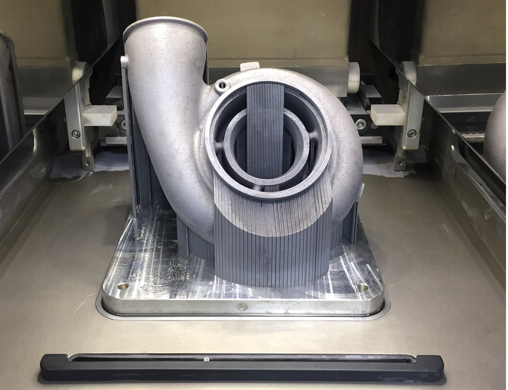

The LPBF system used to print the ramjet was a Velo3D Sapphire 1 MZ, which prints objects up to one meter high (the final ramjet version is 751 mm tall.) Every Sapphire system contains hundreds of sensors that monitor, report, and save metrics throughout each build. “Velo3D’s machine collects an immense amount of data,” Keogh noted. “It also provides a very generous build envelope oriented towards volume manufacturing.”
Two ramjets were printed, along with a variety of material test coupons, referred to as “dog bones” (larger at both ends, for tensile pull-testing) and “detergent pacs” (for density and surface finish evaluation.)

Velo3D printed a scaled-down version of Blake’s ramjet. No support material was needed, due to Velo3D’s Intelligent Fusion functionality and the Sapphire’s patented recoater technology: After each layer of powder is deposited, the blade that normalizes it is closely followed by a vacuum that picks up excess powder and leaves behind a perfect structure. This creates free space between the blade and the part, eliminating the risk of a collision as the part grows (as well as the need for the supports customarily used to achieve the same goal.)
This advanced AM technology also produces a better surface finish at shallow angles; In the ramjet design, these angles were as low as 30 degrees. “It’s a very tricky geometry,” according to Blake. “There are extremely thin walls at that aggressive angle, and those surfaces are perforated with 500-micron holes. There are also steep overhangs and a lot of added dimensions of complexity. Yet the first time we sent it to the printer it came out perfectly, without issue.”
