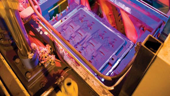

Why shadow modulation, and what is the principle? — Quality defects on castings are often the result of damaged cores or molds. If these are not detected immediately, the damage is often multiplied, and could lead to entire batches being unusable, or present safety risks when the customer has installed them.
Intelligent quality assurance is therefore part of the manufacturing process of molds and cores. A visual inspection system must take into account the specification of the materials. For example, color variations in sand can lead to false alarms and can affect productivity. Not all defects are revealed by a classic halftone visual inspection. Moreover, not every variation may be a defect either. In addition, traditional image processing systems cannot cope with the extreme requirements of day-to-day foundry work.
An innovative system, specially designed for the inspection of sand cores, core packages, and green sand molds makes use of the so-called ‘shadow modulation technique’. It is a pragmatic, easy-to-use and cost-effective qualitative inspection solution.
Fig. 1
The shadow of an object contains fundamental information about its topography. The smallest defects such as cracks or breaks can only be identified once they are enhanced by their shadow. Many areas are hidden for the camera and are only visible through their shadow
Fig. 2.
If you now use a multi-channel illumination set-up, you acquire a series of images that contains much more information than a single picture (Fig.2.) The second benefit of this approach is obvious: This system obtains a lot of redundant information (criteria visible in more than one image.) Redundant information leads to a very stable basis for making a good/bad decision.
However, not all areas are subject to the same quality criteria. The software needs to concentrate on user-definable “regions of interest,” which are actually relevant in terms of product quality. These regions of interest bring operator expertise into the system – important for a reliable evaluation. As a qualitative inspection system, it compares the item being tested with reference images.
Variations that are permitted within the production process should not be evaluated as defects, but should be tolerated. Images of several good parts form the reference dataset so the system is able to learn about the variation of the ‘good class’ of parts. Position correction, compensation for changes in the ambient light and passive or active dust protection make the system particularly sturdy for tough day-to-day foundry use.
