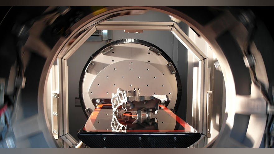

Leveraging the potential of this unused data requires a computed tomography system for rapid – and thus mass – 3D analysis of light metal castings. CT inspection is not a new step for metalcasting operations, the Phoenix Speed|scan CT64 developed by Waygate Technologies (formerly GE Inspection Technologies), opens up fundamentally different ways of using data, for three reasons.
First, the device works exactly like CT systems for medical research and diagnosis, including a rotating CT gantry. This enables fast inspection processes with exceptionally high cycle times: the scan of a cylinder head takes only around 15 to 30 seconds and is thus considerably faster than standard industrial CT processes with flat panel or even line detectors.
Second, the scanner can be loaded and unloaded automatically. The table that holds the test specimen moves out of the system for easy loading and there is no need for the part to be fixed for rotation, as required in other systems. Both of these features facilitate 100% inline inspections and thus the generation of large volumes of data.
The system also can be used in at-line inspection, in the immediate vicinity of several production lines. Reconstruction and evaluation of the data takes place while the next light metal casting is already being scanned.
Third, Waygate Technologies has developed the Speed|ADR and InspectionWorks software platforms for automated defect detection and intelligent data evaluation. These not only provide a highly differentiated, three-dimensional view into the casting, but also allow further analyses and thus can significantly increase productivity in the foundry, as well as the quality of light metal castings.
Quality assessment
By combining these features the Speed|scan CT64 is capable of completely digitizing any manufactured light metal casting (or representative sample, or prototype parts) up to a size of around 900 x 500 mm, and create a digital twin of it. Not only the dimensions are recorded, but also – and this is at least as important – the internal structures of the cast object. In this way, numerous potential casting defects, such as inclusions, shrinkage, chipping, or sand core residues, can be reliably detected even at invisible or non-accessible locations deep inside the light metal casting, and with an accuracy of down to 0.5 mm2. Thus, the quality of the component can be assessed much more reliably than with the destructive testing or surface testing methods commonly used to date, even compared to two-dimensional radiographic inspection.
