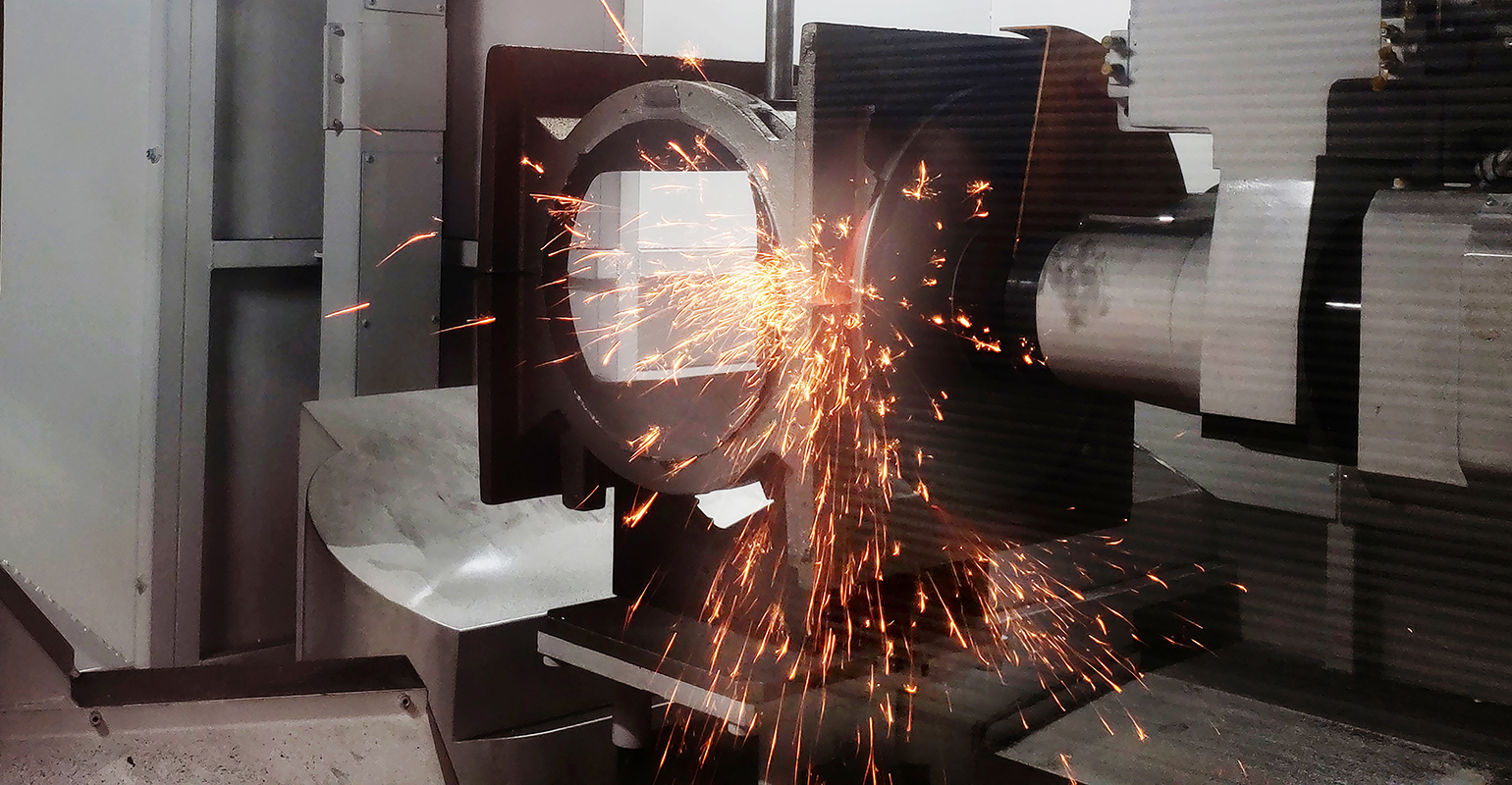

Sinto America Barinder automated grinding system.
