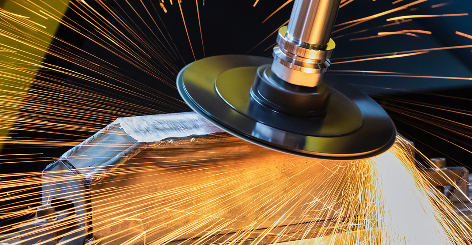

Lincoln Electric Automation / 3M Abrasive Systems Fab-Pak OmniClean all-in-one robotic grinding cell.
