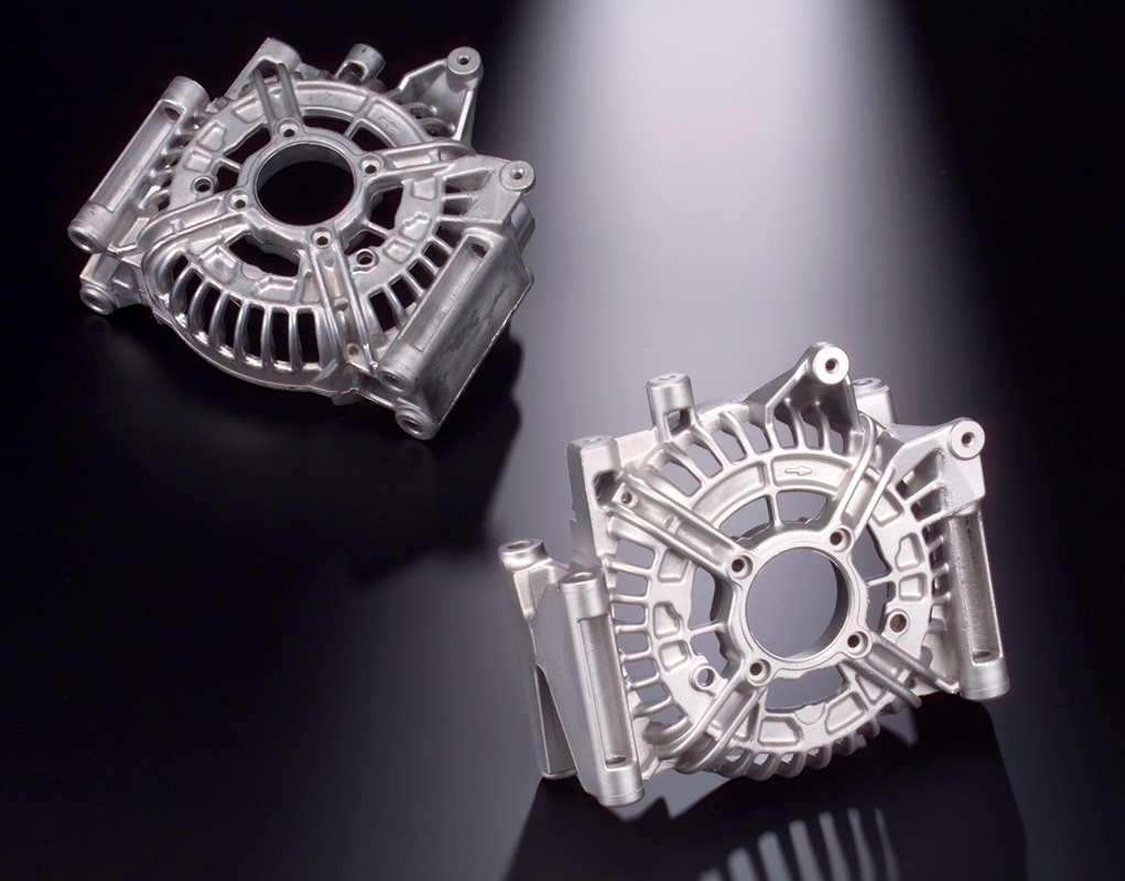

Shot-blast machines with automated workpiece handling for continuous processing of lightweight, nonferrous castings within required cycle times include de-sanding, deburring, and surface homogenization. With a compact design the machine can be integrated into automated manufacturing lines for high throughput of automotive parts.

In-line shot blasting. A major challenge for battery-driven vehicles is to reach a maximum driving range before recharging. In vehicles with combustion engines the fuel consumption and the emissions must be lowered. This leads to an increasing use of nonferrous metals like aluminum and magnesium. These materials are used to produce stator carriers, housings, drive components, axle clamps, and wheel holders as sand castings, diecastings, and injection moldings. Following the shaping process these components must be de-sanded, deburred, and their surfaces must be homogenized. For these tasks Rösler has developed compact swing-chamber shot-blast machines with automated workpiece handling. Because these machines have small footprints, they can be easily integrated into manufacturing lines, thus allowing inline, continuous flow processing.
