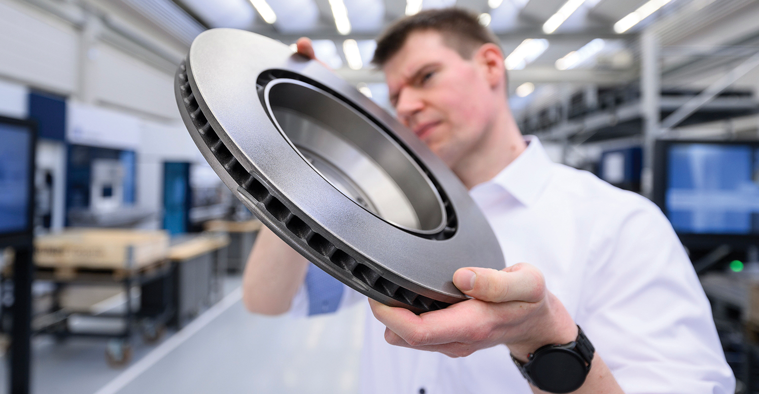

The Trumpf Group’s Laser and System Technology unit has taken a high-tech approach to elevating the value of brake discs by promising to reduce the degradation that occurs with normal use, and more specifically to reduce the particulate matter that results from disc brakes wearing down. The new approach is laser deposition, and the results are being evaluated in series production with some automotive manufacturers and suppliers.
"As a technologically leading laser system manufacturer, we have been working closely with the automotive industry for years and know the market very well,” according to Richard Bannmüller, president and CEO of TRUMPF Laser- and System Technology. “High-speed laser metal deposition is cost-effective, can be used in series production and thus offers the potential to become the new standard in brake disc manufacturing."
Energy efficiency. Laser cladding works through a complex interaction between laser and metal powder, making it possible to create pore- and crack-free layers. The key to the process is the powder and energy input. Instead of applying the metal powder to the component and then melting it there by laser light, in high-speed laser buildup welding the metal powder enters the laser beam just above the component. The light heats the powder to melting temperature even as it is being delivered to the component surface. This makes it possible for brake manufacturers to apply the coating much faster and to use the energy employed much more efficiently to form the layer.
